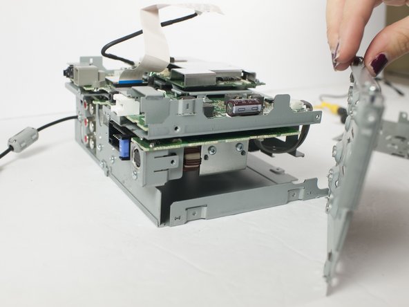

    • Using your fingers and/or a metal spudger, gently release the plastic locking tabs of the front panel assembly from the steel enclosure while prying the front panel assembly away from the steel enclosure with your fingers.
  4. JVC KW-V820BT Driver Side Panel Removal and Replacement: crwdns2935265:04crwdnd2935265:01crwdnd2935265:01crwdne2935265:0
    • Gently remove the front panel from the steel enclosure.

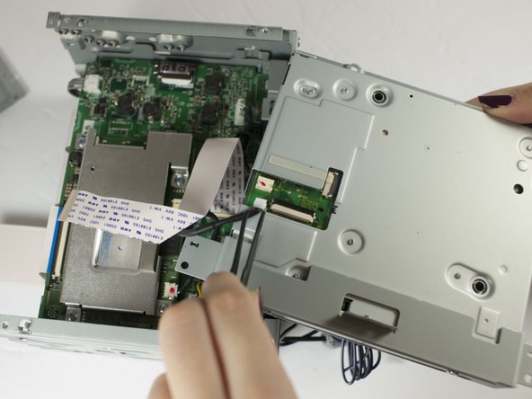

  5. JVC KW-V820BT Driver Side Panel Removal and Replacement: crwdns2935265:05crwdnd2935265:01crwdnd2935265:03crwdne2935265:0 JVC KW-V820BT Driver Side Panel Removal and Replacement: crwdns2935265:05crwdnd2935265:02crwdnd2935265:03crwdne2935265:0 JVC KW-V820BT Driver Side Panel Removal and Replacement: crwdns2935265:05crwdnd2935265:03crwdnd2935265:03crwdne2935265:0
    • Gently separate the ribbon cable from from ZIF connector on the circuit board using a metal smudger.
    • Be careful not to scratch or damage components or features of the circuit board with the metal spudger

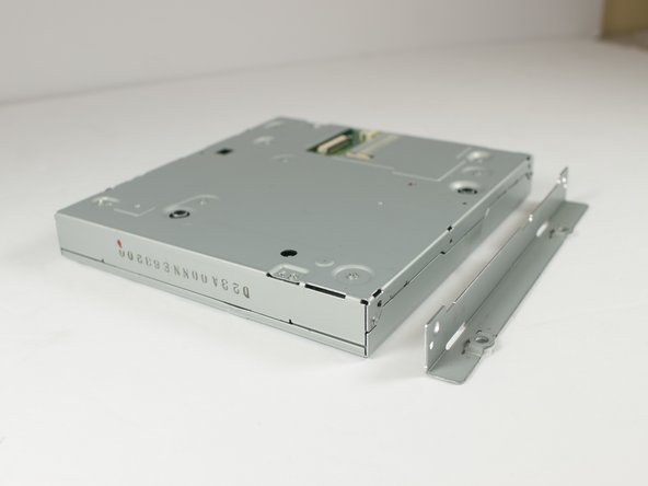

  7. JVC KW-V820BT Driver Side Panel Removal and Replacement, Disc Drive: crwdns2935265:07crwdnd2935265:01crwdnd2935265:01crwdne2935265:0
    • After removing all screws and top panel, lift up disc drive from steel enclosure.
  8. JVC KW-V820BT Driver Side Panel Removal and Replacement: crwdns2935265:08crwdnd2935265:01crwdnd2935265:01crwdne2935265:0
    • Turn over the disc drive to expose the connector.
    • Gently remove the ribbon cable from the ZIF on the circuit board using the metal spudger.
  9. JVC KW-V820BT Driver Side Panel Removal and Replacement: crwdns2935265:09crwdnd2935265:01crwdnd2935265:03crwdne2935265:0 JVC KW-V820BT Driver Side Panel Removal and Replacement: crwdns2935265:09crwdnd2935265:02crwdnd2935265:03crwdne2935265:0 JVC KW-V820BT Driver Side Panel Removal and Replacement: crwdns2935265:09crwdnd2935265:03crwdnd2935265:03crwdne2935265:0
    • Gently pull to remove the electrical connector from disc drive.

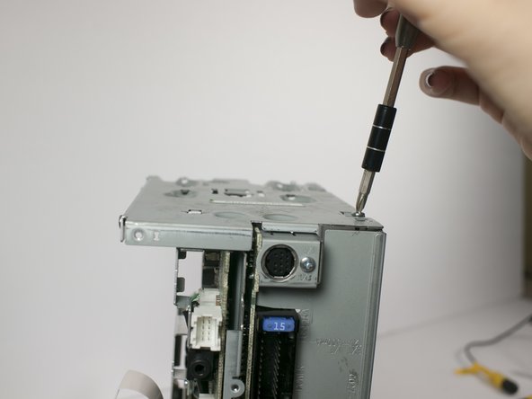

  12. JVC KW-V820BT Driver Side Panel Removal and Replacement, Driver Side Panel Removal and: crwdns2935265:012crwdnd2935265:01crwdnd2935265:03crwdne2935265:0 JVC KW-V820BT Driver Side Panel Removal and Replacement, Driver Side Panel Removal and: crwdns2935265:012crwdnd2935265:02crwdnd2935265:03crwdne2935265:0 JVC KW-V820BT Driver Side Panel Removal and Replacement, Driver Side Panel Removal and: crwdns2935265:012crwdnd2935265:03crwdnd2935265:03crwdne2935265:0
    • Remove the six pan-head, 1/64 x 3/16" machine screws using a Phillips #0 screwdriver.
