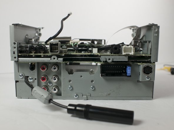

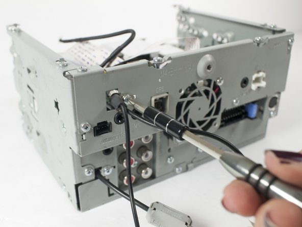

  7. JVC KW-V820BT Cooling Fan Removal and Replacement, Rear Panel Removal and Replacement: crwdns2935265:07crwdnd2935265:01crwdnd2935265:03crwdne2935265:0 JVC KW-V820BT Cooling Fan Removal and Replacement, Rear Panel Removal and Replacement: crwdns2935265:07crwdnd2935265:02crwdnd2935265:03crwdne2935265:0 JVC KW-V820BT Cooling Fan Removal and Replacement, Rear Panel Removal and Replacement: crwdns2935265:07crwdnd2935265:03crwdnd2935265:03crwdne2935265:0
    • Disconnect Video Out/Rear View Camera cable from circuit board.
    • Remove the Video Out/Rear View Camera cable retaining clip using after removing 0-64 x 3/16" machine screw using a Phillips #0 screwdriver.
    • Withdraw Video Out/Rear View Camera cable from rear panel.

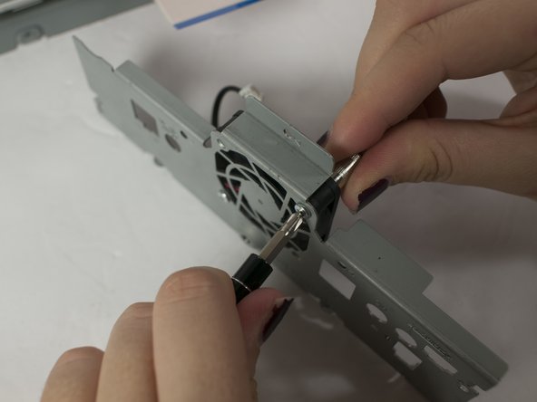

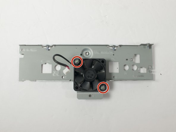

  9. JVC KW-V820BT Cooling Fan Removal and Replacement, Cooling Fan: crwdns2935265:09crwdnd2935265:01crwdnd2935265:03crwdne2935265:0 JVC KW-V820BT Cooling Fan Removal and Replacement, Cooling Fan: crwdns2935265:09crwdnd2935265:02crwdnd2935265:03crwdne2935265:0 JVC KW-V820BT Cooling Fan Removal and Replacement, Cooling Fan: crwdns2935265:09crwdnd2935265:03crwdnd2935265:03crwdne2935265:0
    • Remove the two 1-64 x 1/2" machine screws and the retaining nuts that fasten the cooling fan to the rear panel using the Phillips #0 screwdriver and the 5/32" socket.
