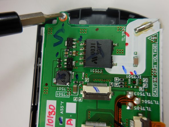

    • Unscrew 3 mm Phillips #0 screws around the LCD Screen. You will have to turn the screen to get the screws on the bottom of the screen.
  2. JVC GR-D93U LCD Screen Replacement: crwdns2935265:02crwdnd2935265:01crwdnd2935265:01crwdne2935265:0

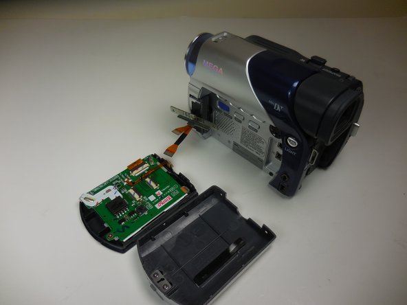

  3. JVC GR-D93U LCD Screen Replacement: crwdns2935265:03crwdnd2935265:01crwdnd2935265:02crwdne2935265:0 JVC GR-D93U LCD Screen Replacement: crwdns2935265:03crwdnd2935265:02crwdnd2935265:02crwdne2935265:0
    • Carefully remove the wires connected to the screen from the black box. Now you will be able to separate the screen from the camera.

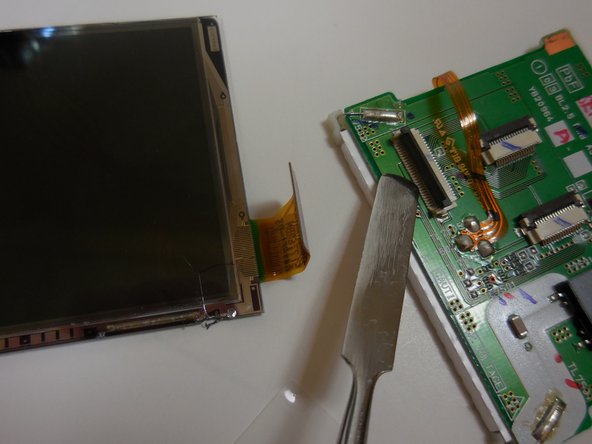

  4. JVC GR-D93U LCD Screen Replacement: crwdns2935265:04crwdnd2935265:01crwdnd2935265:02crwdne2935265:0 JVC GR-D93U LCD Screen Replacement: crwdns2935265:04crwdnd2935265:02crwdnd2935265:02crwdne2935265:0
    • Unscrew the 5 mm Phillips #0 screw that is connecting the screen to the plastic casing.

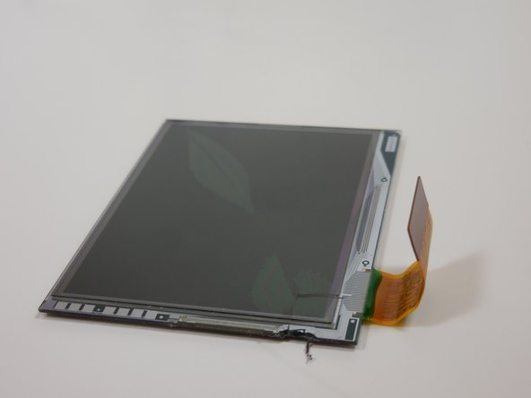

  5. JVC GR-D93U LCD Screen Replacement: crwdns2935265:05crwdnd2935265:01crwdnd2935265:03crwdne2935265:0 JVC GR-D93U LCD Screen Replacement: crwdns2935265:05crwdnd2935265:02crwdnd2935265:03crwdne2935265:0 JVC GR-D93U LCD Screen Replacement: crwdns2935265:05crwdnd2935265:03crwdnd2935265:03crwdne2935265:0
    • You can now take out the screen to be replaced. Carefully remove cables from the data board.
