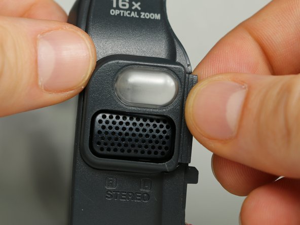

  17. JVC GR-D72U Microphone Replacement, LED Light: crwdns2935265:017crwdnd2935265:01crwdnd2935265:01crwdne2935265:0
    • Remove the three screws securing the microphone housing and camera operation buttons to the frame with the following sizes:
    • 4.3 mm
    • 3.1 mm
    • 4.2 mm
  18. JVC GR-D72U Microphone Replacement: crwdns2935265:018crwdnd2935265:01crwdnd2935265:02crwdne2935265:0 JVC GR-D72U Microphone Replacement: crwdns2935265:018crwdnd2935265:02crwdnd2935265:02crwdne2935265:0
    • Remove the 4.3 mm screw on the bottom of the camera frame.
    • Remove the two 4.3 mm screws above the LED securing the microphone housing to the frame.
  19. JVC GR-D72U Microphone Replacement: crwdns2935265:019crwdnd2935265:01crwdnd2935265:03crwdne2935265:0 JVC GR-D72U Microphone Replacement: crwdns2935265:019crwdnd2935265:02crwdnd2935265:03crwdne2935265:0 JVC GR-D72U Microphone Replacement: crwdns2935265:019crwdnd2935265:03crwdnd2935265:03crwdne2935265:0
    • Open the cassette holder to reveal a 2.4 mm screw on the bottom of the camera and remove it.
    • Make sure the camera operation buttons are positioned completely outside of the camera frame.
    • Gently lift the microphone housing from the front-bottom side of the camera and remove it from the frame.

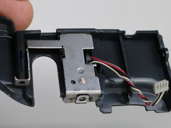

  20. JVC GR-D72U Microphone Replacement: crwdns2935265:020crwdnd2935265:01crwdnd2935265:02crwdne2935265:0 JVC GR-D72U Microphone Replacement: crwdns2935265:020crwdnd2935265:02crwdnd2935265:02crwdne2935265:0
    • Remove the two 2.3 mm screws holding down the LED chip and remove the chip.
    • Ignore this step if you are following this guide for the microphone.
  21. JVC GR-D72U Microphone Replacement, Microphone: crwdns2935265:021crwdnd2935265:01crwdnd2935265:02crwdne2935265:0 JVC GR-D72U Microphone Replacement, Microphone: crwdns2935265:021crwdnd2935265:02crwdnd2935265:02crwdne2935265:0
    • Remove the two 1.6 mm screws securing the microphone casing.
    • Pull off the microphone casing.
  22. JVC GR-D72U Microphone Replacement: crwdns2935265:022crwdnd2935265:01crwdnd2935265:02crwdne2935265:0 JVC GR-D72U Microphone Replacement: crwdns2935265:022crwdnd2935265:02crwdnd2935265:02crwdne2935265:0
    • Pry up the two tabs and push them to remove the microphone cover.
  23. JVC GR-D72U Microphone Replacement: crwdns2935265:023crwdnd2935265:01crwdnd2935265:02crwdne2935265:0 JVC GR-D72U Microphone Replacement: crwdns2935265:023crwdnd2935265:02crwdnd2935265:02crwdne2935265:0
    • Use a metal spudger to lift the microphone out of its housing.
