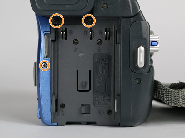

    • From the bottom of the camera remove the following four screws:
    • 5.3 mm
    • 3.1 mm
    • 5.1 mm
    • 3.5 mm

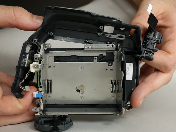

    • Gently pull apart both halves of the camera to reveal the inner components.

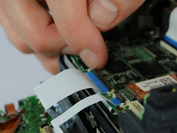

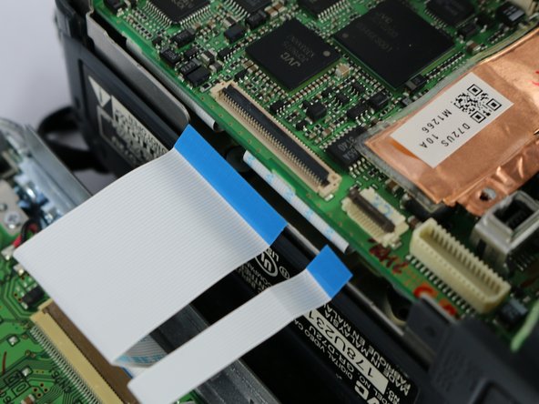

  9. JVC GR-D72U LED Light Replacement: crwdns2935265:09crwdnd2935265:01crwdnd2935265:03crwdne2935265:0 JVC GR-D72U LED Light Replacement: crwdns2935265:09crwdnd2935265:02crwdnd2935265:03crwdne2935265:0 JVC GR-D72U LED Light Replacement: crwdns2935265:09crwdnd2935265:03crwdnd2935265:03crwdne2935265:0
    • Flip the cable locks to the up-position and pull both cables connecting the lateral function port panel to the rest of the camera.
    • Insert the cables from the new port panel into their inputs and flip the locks to the down position.
    • It is easier to use tweezers when inserting the cable but not required.

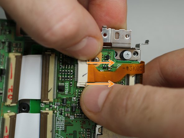

    • Unplug the three cables from the circuit board.

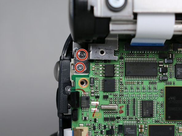

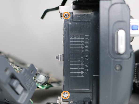

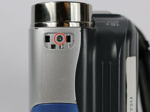

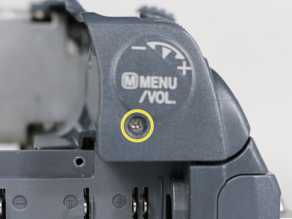

    • From the top of the camera remove the two 3.1 mm screws securing the lens to the camera frame.

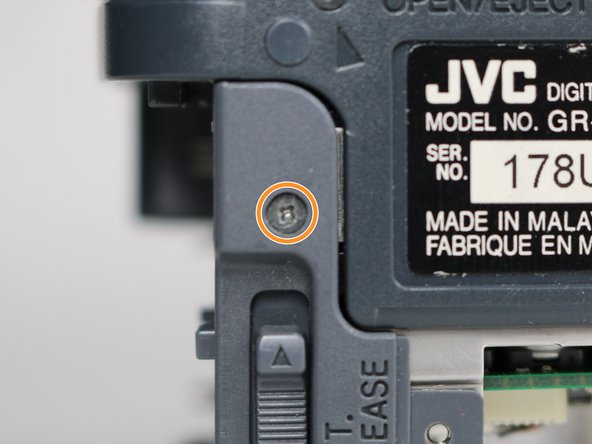

    • From the bottom of the camera remove the 3.2 mm screw next to the battery release switch.
    • Remove the 9.1 mm screw next to the menu and volume control label.

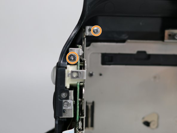

  13. JVC GR-D72U LED Light Replacement: crwdns2935265:013crwdnd2935265:01crwdnd2935265:02crwdne2935265:0 JVC GR-D72U LED Light Replacement: crwdns2935265:013crwdnd2935265:02crwdnd2935265:02crwdne2935265:0
    • Remove the lens cap housing.
    • Remove the two 3.1 mm screws from the inside of the camera.

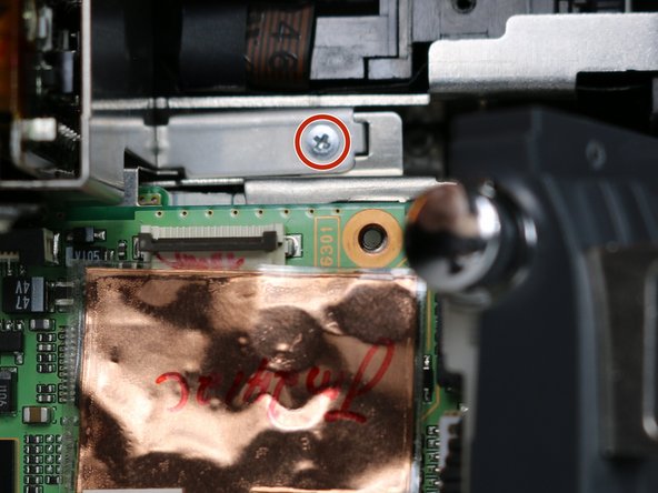

    • Remove the 3.1 mm screw securing the lens to the circuit board.

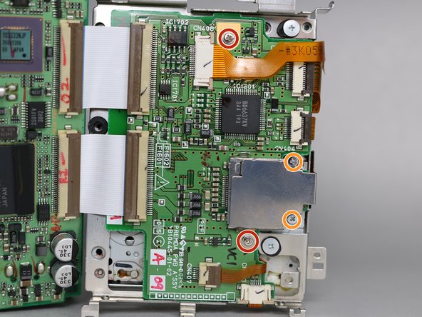

    • Take the cassette holder and circuit board by lifting it out of the camera frame.
    • Remove the two 3.6 mm screws.
    • Remove the two 1.8 mm screws then the plate.
    • If you are following this guide to replace the LED light or microphone you do not need to follow this step or the next step.

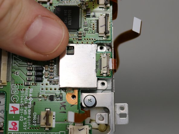

  16. JVC GR-D72U LED Light Replacement: crwdns2935265:016crwdnd2935265:01crwdnd2935265:03crwdne2935265:0 JVC GR-D72U LED Light Replacement: crwdns2935265:016crwdnd2935265:02crwdnd2935265:03crwdne2935265:0 JVC GR-D72U LED Light Replacement: crwdns2935265:016crwdnd2935265:03crwdnd2935265:03crwdne2935265:0
    • Remove the six cables (one is underneath the metal plate) connecting the cassette holder to the circuit board.
    • To unplug two of the cables you must first pull the lock tabs out (towards the cable) then remove the cable.

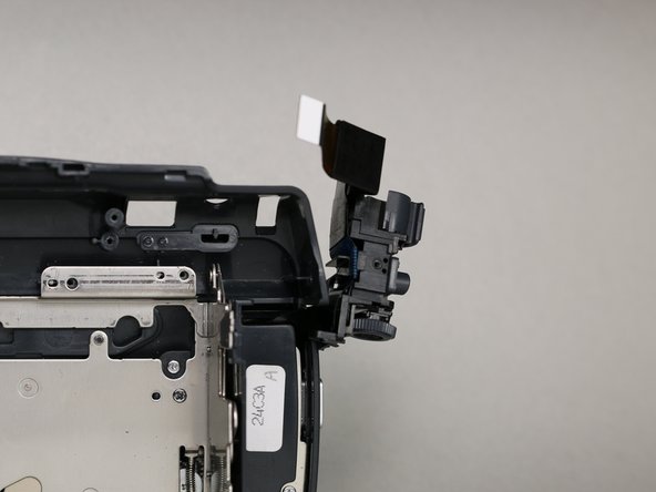

  17. JVC GR-D72U LED Light Replacement, LED Light: crwdns2935265:017crwdnd2935265:01crwdnd2935265:01crwdne2935265:0
    • Remove the three screws securing the microphone housing and camera operation buttons to the frame with the following sizes:
    • 4.3 mm
    • 3.1 mm
    • 4.2 mm
  18. JVC GR-D72U LED Light Replacement: crwdns2935265:018crwdnd2935265:01crwdnd2935265:02crwdne2935265:0 JVC GR-D72U LED Light Replacement: crwdns2935265:018crwdnd2935265:02crwdnd2935265:02crwdne2935265:0
    • Remove the 4.3 mm screw on the bottom of the camera frame.
    • Remove the two 4.3 mm screws above the LED securing the microphone housing to the frame.
  19. JVC GR-D72U LED Light Replacement: crwdns2935265:019crwdnd2935265:01crwdnd2935265:03crwdne2935265:0 JVC GR-D72U LED Light Replacement: crwdns2935265:019crwdnd2935265:02crwdnd2935265:03crwdne2935265:0 JVC GR-D72U LED Light Replacement: crwdns2935265:019crwdnd2935265:03crwdnd2935265:03crwdne2935265:0
    • Open the cassette holder to reveal a 2.4 mm screw on the bottom of the camera and remove it.
    • Make sure the camera operation buttons are positioned completely outside of the camera frame.
    • Gently lift the microphone housing from the front-bottom side of the camera and remove it from the frame.
  20. JVC GR-D72U LED Light Replacement: crwdns2935265:020crwdnd2935265:01crwdnd2935265:02crwdne2935265:0 JVC GR-D72U LED Light Replacement: crwdns2935265:020crwdnd2935265:02crwdnd2935265:02crwdne2935265:0

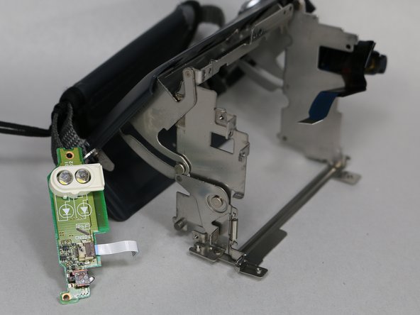

    • Remove the two 2.3 mm screws holding down the LED chip and remove the chip.
    • Ignore this step if you are following this guide for the microphone.
