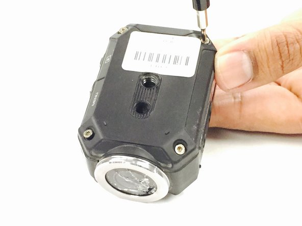

    • Using a 1x1xH1.5 torx screwdriver, remove the eight screws (5mm headsize / 4mm length) from the corners of both sides of the camera (4 screws on each side).

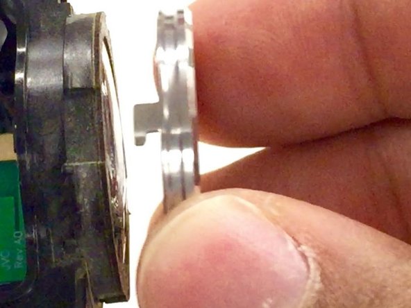

    • Twist the metal ring on the lens to the right and then pull it off.
  9. JVC Adixxion GC-XA1BU Lens (External) Replacement: crwdns2935265:09crwdnd2935265:01crwdnd2935265:02crwdne2935265:0 JVC Adixxion GC-XA1BU Lens (External) Replacement: crwdns2935265:09crwdnd2935265:02crwdnd2935265:02crwdne2935265:0

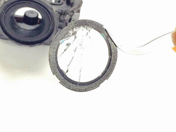

    • Use the plastic opening tool to gently pry the lens off of the camera.
