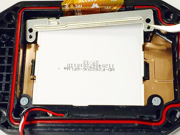

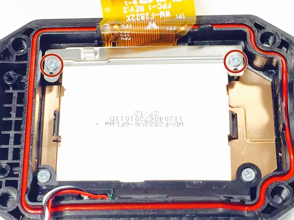

  13. JVC Adixxion GC-XA1BU LCD Screen Replacement, Zoom (+/-) Buttons: crwdns2935265:013crwdnd2935265:01crwdnd2935265:02crwdne2935265:0 JVC Adixxion GC-XA1BU LCD Screen Replacement, Zoom (+/-) Buttons: crwdns2935265:013crwdnd2935265:02crwdnd2935265:02crwdne2935265:0
    • Use a Phillips #00 screwdriver to remove the two top screws (4mmx x 3mm). Once the screws are removed, carefully lift off the silver plate using Tweezers.

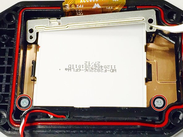

  14. JVC Adixxion GC-XA1BU LCD Screen Replacement: crwdns2935265:014crwdnd2935265:01crwdnd2935265:01crwdne2935265:0
    • Once you have lifted and removed the silver plate, use a Phillips #00 screwdriver to remove the two bottom screws (4mm x 3mm).

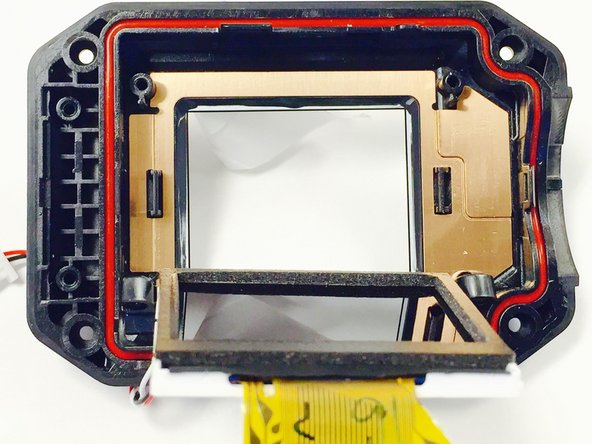

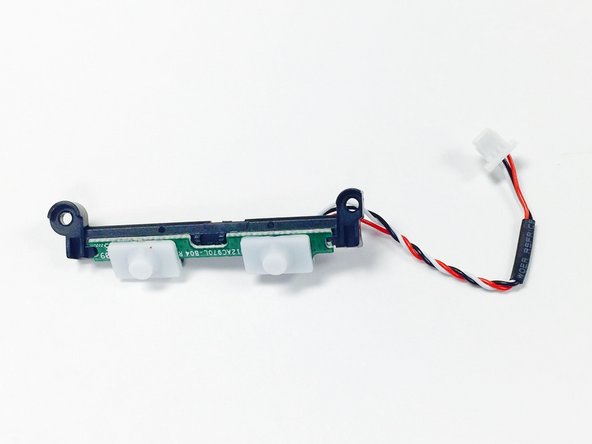

  15. JVC Adixxion GC-XA1BU LCD Screen Replacement: crwdns2935265:015crwdnd2935265:01crwdnd2935265:02crwdne2935265:0 JVC Adixxion GC-XA1BU LCD Screen Replacement: crwdns2935265:015crwdnd2935265:02crwdnd2935265:02crwdne2935265:0
    • Using Tweezers, gently pull the red, black, and white threaded wire to disconnect it, then remove the attached panel as shown.

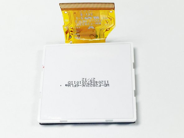

  16. JVC Adixxion GC-XA1BU LCD Screen Replacement, LCD Screen: crwdns2935265:016crwdnd2935265:01crwdnd2935265:02crwdne2935265:0 JVC Adixxion GC-XA1BU LCD Screen Replacement, LCD Screen: crwdns2935265:016crwdnd2935265:02crwdnd2935265:02crwdne2935265:0
    • Carefully lift up and remove the LCD screen using the tweezers.
  17. JVC Adixxion GC-XA1BU LCD Screen Replacement: crwdns2935265:017crwdnd2935265:01crwdnd2935265:02crwdne2935265:0 JVC Adixxion GC-XA1BU LCD Screen Replacement: crwdns2935265:017crwdnd2935265:02crwdnd2935265:02crwdne2935265:0
    • The screen as shown if removed properly.
Follow these steps in reverse order with the new LCD screen in order to complete the replacement.
