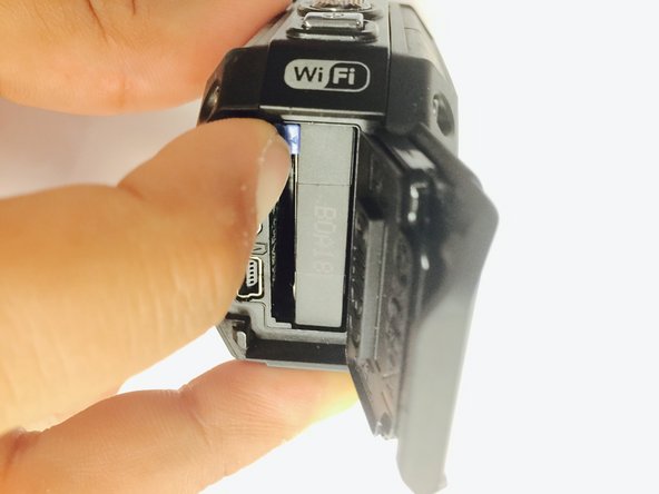

  4. JVC Adixxion GC-XA1BU LCD Cover Replacement: crwdns2935265:04crwdnd2935265:01crwdnd2935265:02crwdne2935265:0 JVC Adixxion GC-XA1BU LCD Cover Replacement: crwdns2935265:04crwdnd2935265:02crwdnd2935265:02crwdne2935265:0
    • Open the battery compartment and push the blue battery release switch.
  5. JVC Adixxion GC-XA1BU LCD Cover Replacement: crwdns2935265:05crwdnd2935265:01crwdnd2935265:01crwdne2935265:0
    • Remove the battery from the camera.

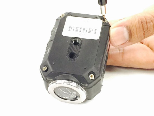

  7. JVC Adixxion GC-XA1BU LCD Cover Replacement, LCD Cover: crwdns2935265:07crwdnd2935265:01crwdnd2935265:02crwdne2935265:0 JVC Adixxion GC-XA1BU LCD Cover Replacement, LCD Cover: crwdns2935265:07crwdnd2935265:02crwdnd2935265:02crwdne2935265:0
    • Remove the 8 screws (5mm x 4mm) from the corners of both the front and back of the camera (4 screws on each side) using the T6 Torx screwdriver.

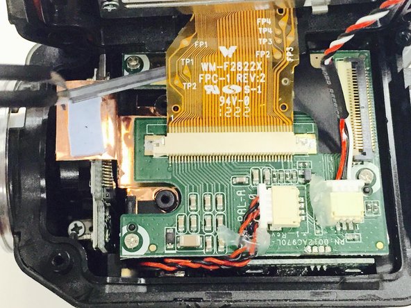

  8. JVC Adixxion GC-XA1BU LCD Cover Replacement: crwdns2935265:08crwdnd2935265:01crwdnd2935265:01crwdne2935265:0
    • Carefully open the camera as shown and gently peel off the black cover tape.

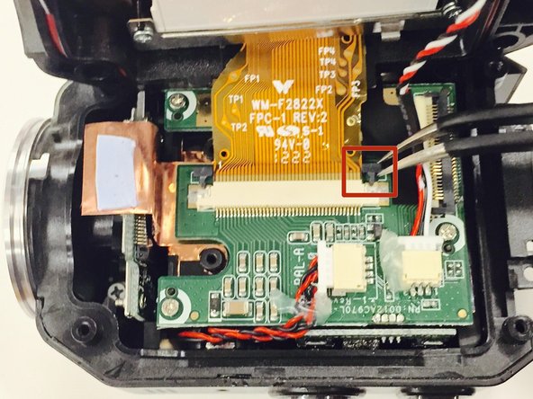

    • Carefully lift up and remove the cable ribbon clip using the tweezers.

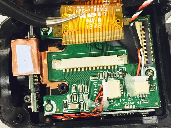

  10. JVC Adixxion GC-XA1BU LCD Cover Replacement: crwdns2935265:010crwdnd2935265:01crwdnd2935265:02crwdne2935265:0 JVC Adixxion GC-XA1BU LCD Cover Replacement: crwdns2935265:010crwdnd2935265:02crwdnd2935265:02crwdne2935265:0
    • Carefully grasp and remove the ribbon cable using the tweezers.

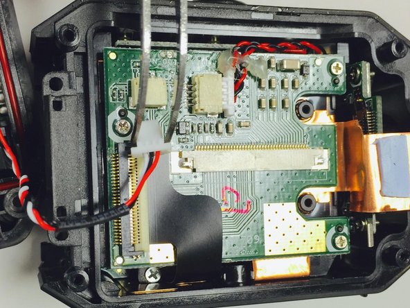

  12. JVC Adixxion GC-XA1BU LCD Cover Replacement: crwdns2935265:012crwdnd2935265:01crwdnd2935265:02crwdne2935265:0 JVC Adixxion GC-XA1BU LCD Cover Replacement: crwdns2935265:012crwdnd2935265:02crwdnd2935265:02crwdne2935265:0
    • Carefully pull the white clip out of the casing using the tweezers.
