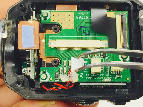

  13. JVC Adixxion GC-XA1BU Battery Housing Replacement, Battery Housing: crwdns2935265:013crwdnd2935265:01crwdnd2935265:02crwdne2935265:0 JVC Adixxion GC-XA1BU Battery Housing Replacement, Battery Housing: crwdns2935265:013crwdnd2935265:02crwdnd2935265:02crwdne2935265:0
    • Carefully peel off the glue holding the red and black braided wire down to the circuit board.
    • Then remove the connector by gently pulling it out of its casing.
    • You will want to save this glue as it may come in handy when re-assembling your device.

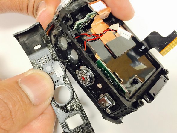

  17. JVC Adixxion GC-XA1BU Battery Housing Replacement: crwdns2935265:017crwdnd2935265:01crwdnd2935265:02crwdne2935265:0 JVC Adixxion GC-XA1BU Battery Housing Replacement: crwdns2935265:017crwdnd2935265:02crwdnd2935265:02crwdne2935265:0
    • Use the plastic opening tool to gently remove the top cover from the camera.
    • It is glued on, so you may need to work at it to get it to come off.
  18. JVC Adixxion GC-XA1BU Battery Housing Replacement: crwdns2935265:018crwdnd2935265:01crwdnd2935265:01crwdne2935265:0
    • Once the cover has been removed, you will want to remove the three Phillips screws (2mm headsize x 2mm length) that are underneath.

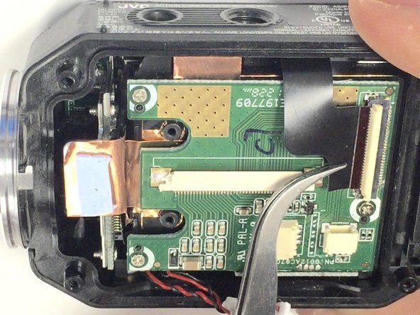

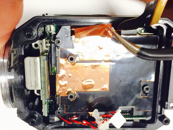

  19. JVC Adixxion GC-XA1BU Battery Housing Replacement: crwdns2935265:019crwdnd2935265:01crwdnd2935265:02crwdne2935265:0 JVC Adixxion GC-XA1BU Battery Housing Replacement: crwdns2935265:019crwdnd2935265:02crwdnd2935265:02crwdne2935265:0
    • Carefully remove both the top and bottom copper strips by gently pulling them off with the tweezers.

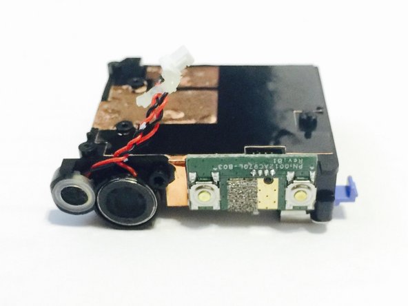

  20. JVC Adixxion GC-XA1BU Battery Housing Replacement: crwdns2935265:020crwdnd2935265:01crwdnd2935265:02crwdne2935265:0 JVC Adixxion GC-XA1BU Battery Housing Replacement: crwdns2935265:020crwdnd2935265:02crwdnd2935265:02crwdne2935265:0
    • Now you should be able to gently remove the battery housing out of the device.
    • If you are having difficulty getting the battery housing to come out, you may want to use the plastic opening tool to help get it started.

I couldn't save the glue from the top cover in order to reassembly it. Does this glue has the function to repel the water or its main function is just to glue together the top cover?
