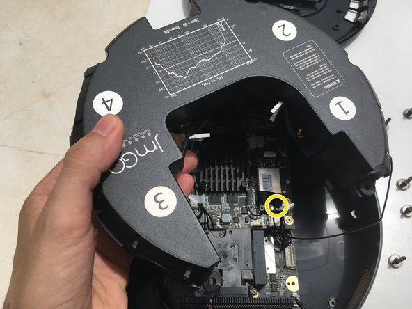

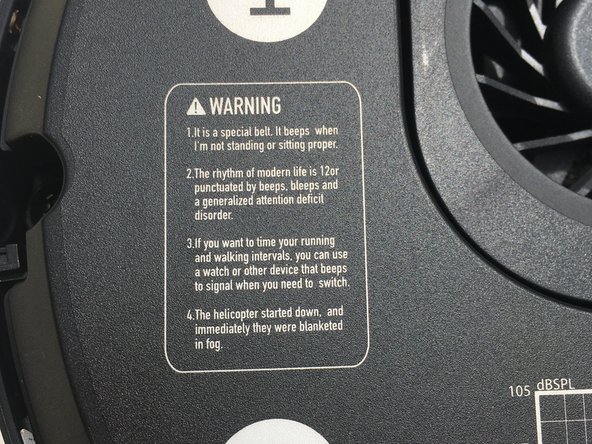

    3. JMGO GS1 Disassembly, Internals: crwdns2935265:03crwdnd2935265:01crwdnd2935265:02crwdne2935265:0 JMGO GS1 Disassembly, Internals: crwdns2935265:03crwdnd2935265:02crwdnd2935265:02crwdne2935265:0
      • Here you can see the powerful speakers, and the fan that keeps the projector cool. And I think this view is also cool, don't you?
      • The first thing we can see is some information regarding the sound capabilities of the machine. Nice detail.
      • The numbers are just the location of each of the four speakers. Although what it seems the explanation of each of them is... weird. Mix of life advice, and strange facts...

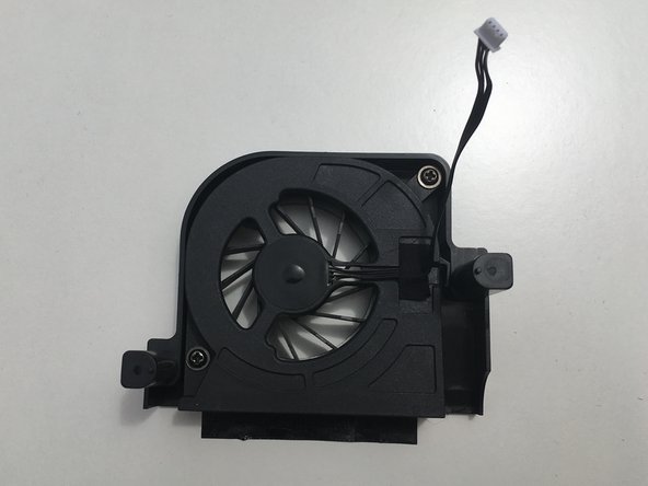

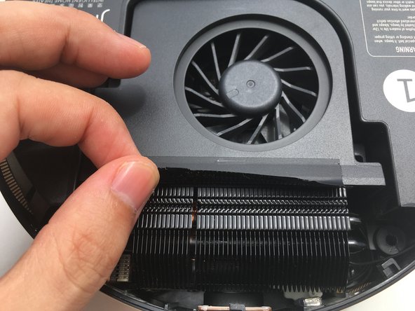

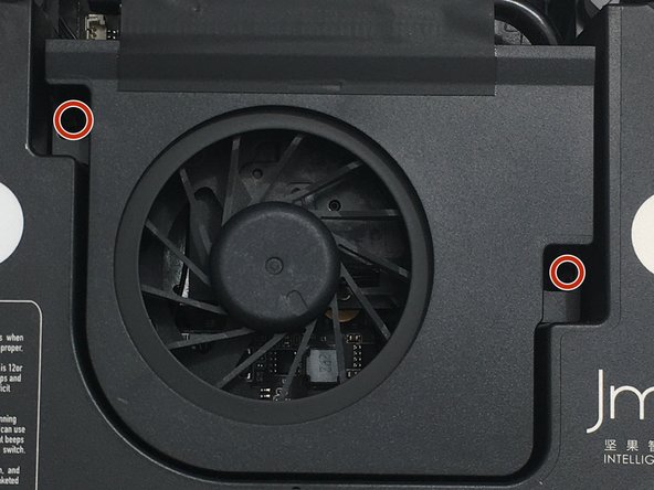

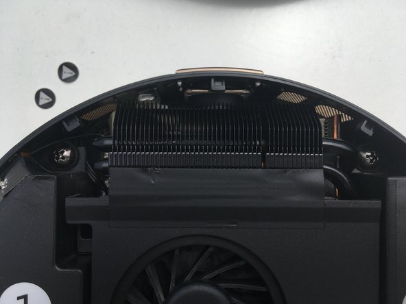

    4. JMGO GS1 Disassembly, Fan: crwdns2935265:04crwdnd2935265:01crwdnd2935265:03crwdne2935265:0 JMGO GS1 Disassembly, Fan: crwdns2935265:04crwdnd2935265:02crwdnd2935265:03crwdne2935265:0 JMGO GS1 Disassembly, Fan: crwdns2935265:04crwdnd2935265:03crwdnd2935265:03crwdne2935265:0
      • Now it's time for the fan.
      • Peel off the sticker joining the fan to the heat sink, you don't need to remove it completely, just to split the two components.
      • Remove the two screws located here.
    5. JMGO GS1 Disassembly, Fan: crwdns2935265:05crwdnd2935265:01crwdnd2935265:03crwdne2935265:0 JMGO GS1 Disassembly, Fan: crwdns2935265:05crwdnd2935265:02crwdnd2935265:03crwdne2935265:0 JMGO GS1 Disassembly, Fan: crwdns2935265:05crwdnd2935265:03crwdnd2935265:03crwdne2935265:0
      • Carefully lift up the fan. Take care as it is still connected to the projector.
      • Pull up the connector to liberate the fan.

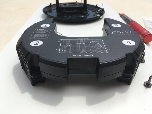

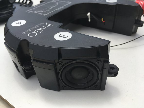

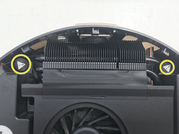

    6. JMGO GS1 Disassembly, Speakers: crwdns2935265:06crwdnd2935265:01crwdnd2935265:03crwdne2935265:0 JMGO GS1 Disassembly, Speakers: crwdns2935265:06crwdnd2935265:02crwdnd2935265:03crwdne2935265:0 JMGO GS1 Disassembly, Speakers: crwdns2935265:06crwdnd2935265:03crwdnd2935265:03crwdne2935265:0
      • The Speakers have a total of 6 screws.
      • Two of them are covered by a warn signal. Don't worry, take off the sticks and, go ahead!
      • You see? no dragons down there.

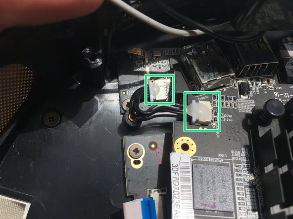

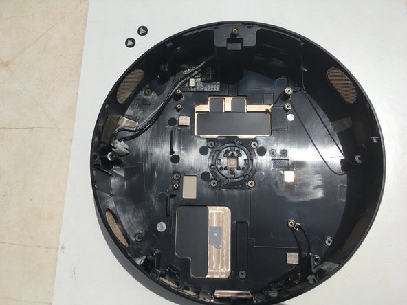

    7. JMGO GS1 Disassembly, Speakers: crwdns2935265:07crwdnd2935265:01crwdnd2935265:03crwdne2935265:0 JMGO GS1 Disassembly, Speakers: crwdns2935265:07crwdnd2935265:02crwdnd2935265:03crwdne2935265:0 JMGO GS1 Disassembly, Speakers: crwdns2935265:07crwdnd2935265:03crwdnd2935265:03crwdne2935265:0
      • Lift slightly up the speakers to have access to the connectors to the matherboard.
      • Pull out the connectors and free the speakers.

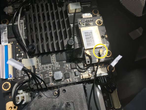

      • Don't pull out completely yet! The speakers also host an antenna, and the connector is still attached to the matherboard.
      • Disconnect the antena from the WiFi/Bluetooth card and free the speakers.
    8. JMGO GS1 Disassembly, Speakers: crwdns2935265:08crwdnd2935265:01crwdnd2935265:03crwdne2935265:0 JMGO GS1 Disassembly, Speakers: crwdns2935265:08crwdnd2935265:02crwdnd2935265:03crwdne2935265:0 JMGO GS1 Disassembly, Speakers: crwdns2935265:08crwdnd2935265:03crwdnd2935265:03crwdne2935265:0
      • Here you can see the antenna attached to the speakers.
      • And a little more detail on the speaker component itself.

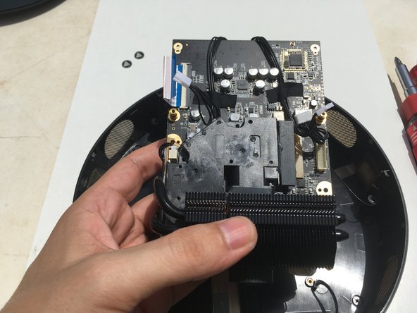

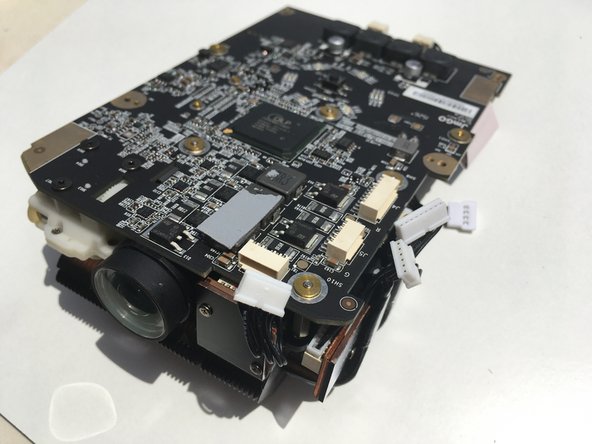

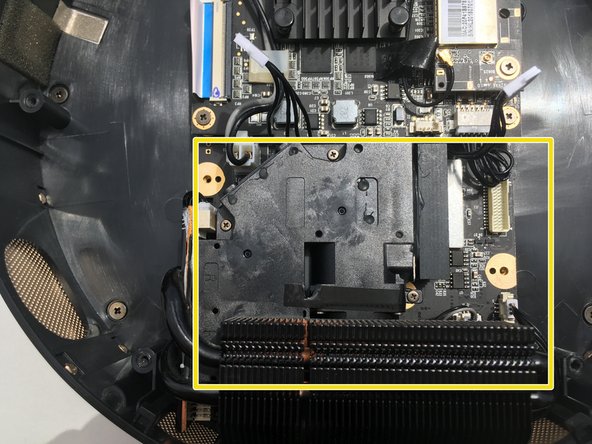

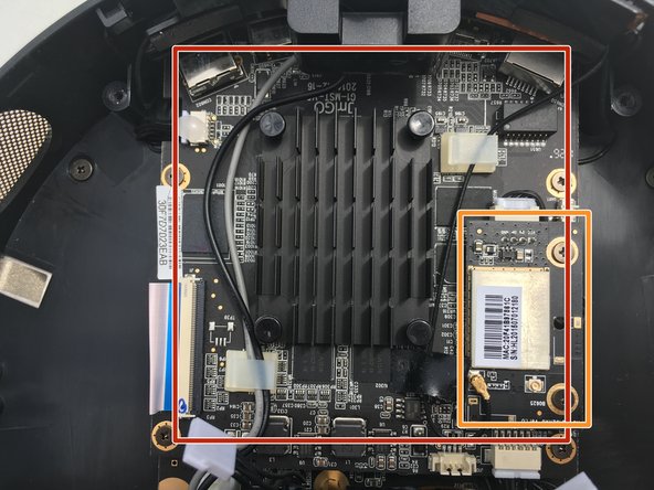

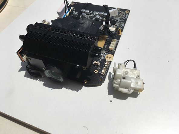

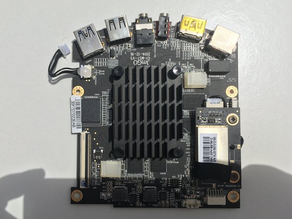

    9. JMGO GS1 Disassembly, Main board and optics: crwdns2935265:09crwdnd2935265:01crwdnd2935265:03crwdne2935265:0 JMGO GS1 Disassembly, Main board and optics: crwdns2935265:09crwdnd2935265:02crwdnd2935265:03crwdne2935265:0 JMGO GS1 Disassembly, Main board and optics: crwdns2935265:09crwdnd2935265:03crwdnd2935265:03crwdne2935265:0
      • Here we can see what is left from the device.
      • The main board, which hosts the Android OS.
      • This is the WiFi module.
      • And the optics part of the projector. Underneath the main board there is the other part for the projector to work: the DLP electronics.
      • Time to continue disassembling it.

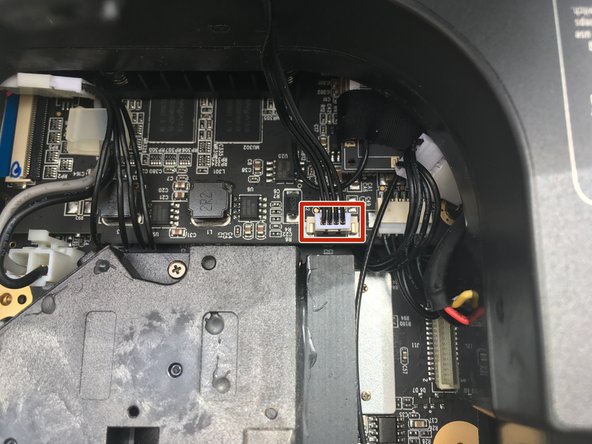

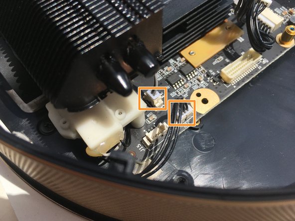

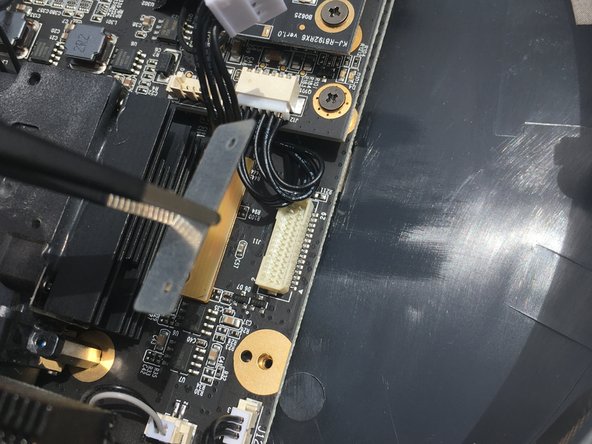

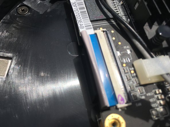

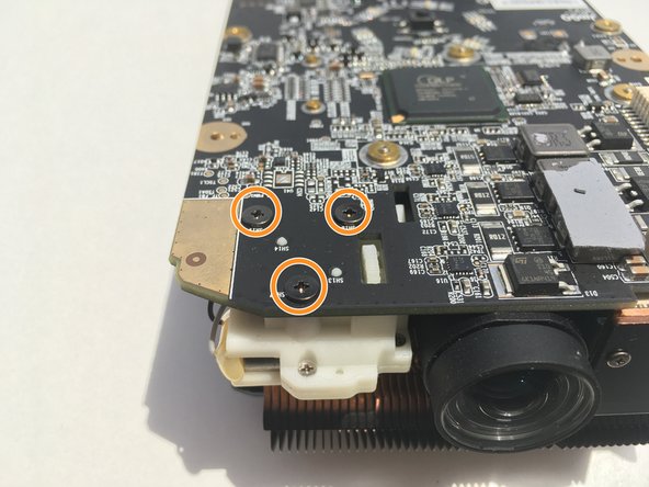

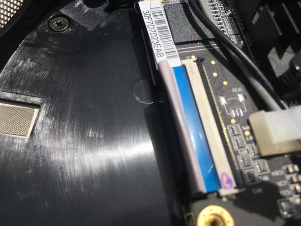

    10. JMGO GS1 Disassembly, Main board: crwdns2935265:010crwdnd2935265:01crwdnd2935265:03crwdne2935265:0 JMGO GS1 Disassembly, Main board: crwdns2935265:010crwdnd2935265:02crwdnd2935265:03crwdne2935265:0 JMGO GS1 Disassembly, Main board: crwdns2935265:010crwdnd2935265:03crwdnd2935265:03crwdne2935265:0
      • We start disconnecting power cable, and the connection with the DPL board.
      • Then unscrew the three left screws securing the board to the main body.
      • Then we open carefully the gate that holds the ribbon cable as shown in the next two pictures. Just pull out and up.
      • Don't push the board just yet, we need to undo another connection in the next step.
    11. JMGO GS1 Disassembly, Main board: crwdns2935265:011crwdnd2935265:01crwdnd2935265:03crwdne2935265:0 JMGO GS1 Disassembly, Main board: crwdns2935265:011crwdnd2935265:02crwdnd2935265:03crwdne2935265:0 JMGO GS1 Disassembly, Main board: crwdns2935265:011crwdnd2935265:03crwdnd2935265:03crwdne2935265:0
      • Move the board a little bit to the side to expose the last connection.
      • The both connectors at the end of the cable are held in place by glue. Chose the one easier for you to disconnect.
      • When assembling back the device, there is no need to put glue back.

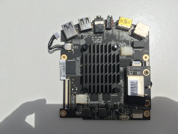

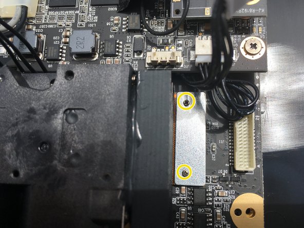

    12. JMGO GS1 Disassembly, DLP board: crwdns2935265:012crwdnd2935265:01crwdnd2935265:03crwdne2935265:0 JMGO GS1 Disassembly, DLP board: crwdns2935265:012crwdnd2935265:02crwdnd2935265:03crwdne2935265:0 JMGO GS1 Disassembly, DLP board: crwdns2935265:012crwdnd2935265:03crwdnd2935265:03crwdne2935265:0
      • Now we will disassembly the DLP board.
      • I think this board is the bluetooth, but not sure.
      • First, we unscrew the plate securing the connection of the board with the optics.
    13. JMGO GS1 Disassembly, DLP board: crwdns2935265:013crwdnd2935265:01crwdnd2935265:03crwdne2935265:0 JMGO GS1 Disassembly, DLP board: crwdns2935265:013crwdnd2935265:02crwdnd2935265:03crwdne2935265:0 JMGO GS1 Disassembly, DLP board: crwdns2935265:013crwdnd2935265:03crwdnd2935265:03crwdne2935265:0
      • We disconnect the antenna.
      • This two screws.
      • And some more connections.
      • And the whole board can know be extracted.

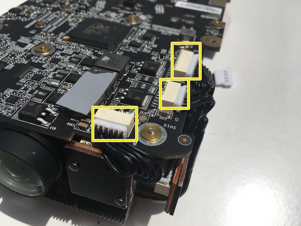

    16. JMGO GS1 Disassembly, Separate the optics: crwdns2935265:016crwdnd2935265:01crwdnd2935265:03crwdne2935265:0 JMGO GS1 Disassembly, Separate the optics: crwdns2935265:016crwdnd2935265:02crwdnd2935265:03crwdne2935265:0 JMGO GS1 Disassembly, Separate the optics: crwdns2935265:016crwdnd2935265:03crwdnd2935265:03crwdne2935265:0
      • There are four screws to undo.
      • And these three connections.
    17. JMGO GS1 Disassembly, Separate the optics: crwdns2935265:017crwdnd2935265:01crwdnd2935265:01crwdne2935265:0

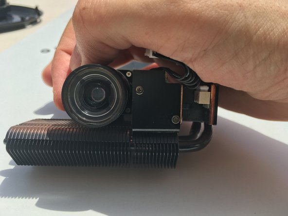

    18. JMGO GS1 Disassembly, How the focus works: crwdns2935265:018crwdnd2935265:01crwdnd2935265:02crwdne2935265:0 JMGO GS1 Disassembly, How the focus works: crwdns2935265:018crwdnd2935265:02crwdnd2935265:02crwdne2935265:0
      • The motor uses a small lever to move the focus.
      • This is how it looks in the lower position.

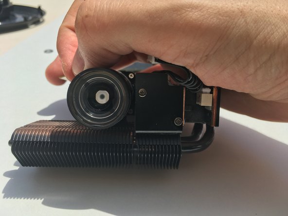

    19. JMGO GS1 Disassembly, How the focus works: crwdns2935265:019crwdnd2935265:01crwdnd2935265:02crwdne2935265:0 JMGO GS1 Disassembly, How the focus works: crwdns2935265:019crwdnd2935265:02crwdnd2935265:02crwdne2935265:0
      • And this is how it looks in the upper position.
      • And now, in full motion.
