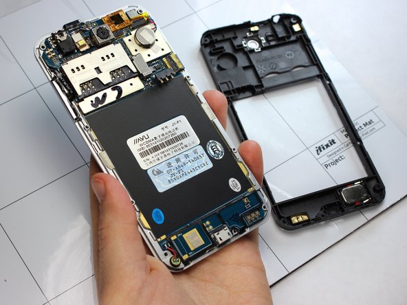

    • With the phone lying face down, remove the nine 3 mm Phillips # 00 screws from the midframe.

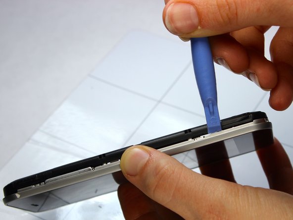

    • Gently run a plastic opening tool down along the left and right sides of the phone to separate the black midframe assembly from the silver display casing.
    • Carefully remove the midframe assembly from the display casing by pulling up and away from the phone.

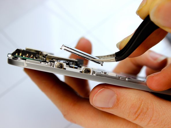

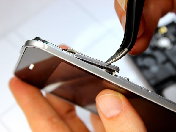

    • Locate the silver volume button on the side of the phone.
    • Use the precision tweezers to slide the volume button out of the groove.
    • When replacing the volume button align the flat side of the button to the silver edge of the display with the rounded edge facing the black frame.
