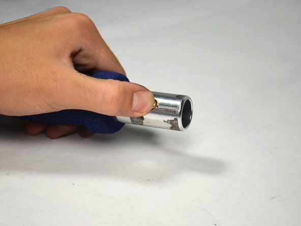

  3. JD Razor 2000 Fastening Button on Handle Bar Replacement, Pulling Out the Handlebar: crwdns2935265:03crwdnd2935265:01crwdnd2935265:02crwdne2935265:0 JD Razor 2000 Fastening Button on Handle Bar Replacement, Pulling Out the Handlebar: crwdns2935265:03crwdnd2935265:02crwdnd2935265:02crwdne2935265:0
    • Press down firmly on the golden fastening button located on the handle bar being replaced.
    • While still pressing down on the fastening button, slide the handle bar apart from the T Bar.
    • When re-installing the handlebar (after completion of the guide), you may need a pair of needle-nosed pliers to thread the string back through the handlebar.
  4. JD Razor 2000 Fastening Button on Handle Bar Replacement, Depressing the Button: crwdns2935265:04crwdnd2935265:01crwdnd2935265:02crwdne2935265:0 JD Razor 2000 Fastening Button on Handle Bar Replacement, Depressing the Button: crwdns2935265:04crwdnd2935265:02crwdnd2935265:02crwdne2935265:0
    • Press strongly down on the golden fastening button located on the loose handle bar.

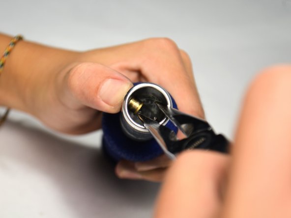

    • Tilt the opening of the handle towards you.

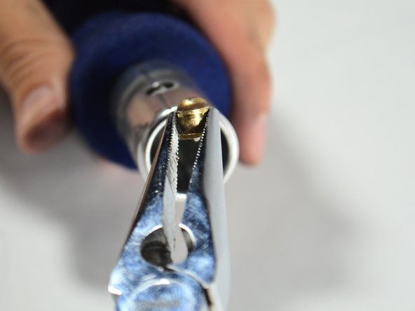

    • Reach in carefully with the small needle-nose pliers and firmly grab the golden fastening button.
  6. JD Razor 2000 Fastening Button on Handle Bar Replacement, Pulling out the Button: crwdns2935265:06crwdnd2935265:01crwdnd2935265:02crwdne2935265:0 JD Razor 2000 Fastening Button on Handle Bar Replacement, Pulling out the Button: crwdns2935265:06crwdnd2935265:02crwdnd2935265:02crwdne2935265:0
    • Once grasping the golden fastening button tightly with small needle-nosed pliers, carefully and slowly pull it out of the handle bar.
    • Do not pull out the fastening button rapidly. This may result in the button shooting across the room with great speed.
