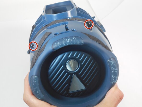

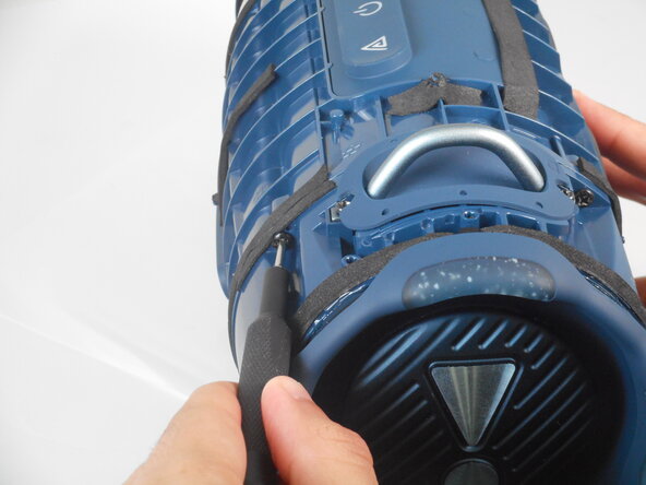

  5. JBL Xtreme 4 Passive Radiator Replacement: crwdns2935265:05crwdnd2935265:01crwdnd2935265:01crwdne2935265:0
    • Use a Phillips screwdriver to remove the two 8.5 mm screws on either side of the battery compartment.

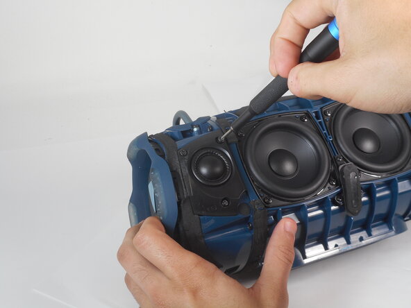

  7. JBL Xtreme 4 Passive Radiator Replacement, Passive Radiator: crwdns2935265:07crwdnd2935265:01crwdnd2935265:03crwdne2935265:0 JBL Xtreme 4 Passive Radiator Replacement, Passive Radiator: crwdns2935265:07crwdnd2935265:02crwdnd2935265:03crwdne2935265:0 JBL Xtreme 4 Passive Radiator Replacement, Passive Radiator: crwdns2935265:07crwdnd2935265:03crwdnd2935265:03crwdne2935265:0
    • Use a Phillips screwdriver to remove the three 8.5 mm screws on the tweeter.
    • Pull the tweeter out from the device.

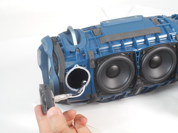

  8. JBL Xtreme 4 Passive Radiator Replacement: crwdns2935265:08crwdnd2935265:01crwdnd2935265:02crwdne2935265:0 JBL Xtreme 4 Passive Radiator Replacement: crwdns2935265:08crwdnd2935265:02crwdnd2935265:02crwdne2935265:0
    • Pinch the cable connection for the tweeters and pull off.
    • Repeat the previous bullet for the second cable.
