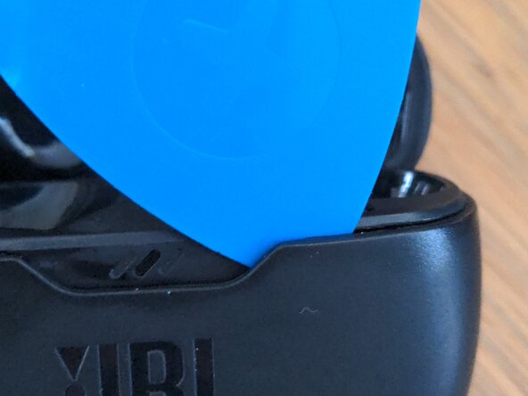

  2. JBL Wave Beam Case Disassembly, Insert a plastic pick: crwdns2935265:02crwdnd2935265:01crwdnd2935265:02crwdne2935265:0 JBL Wave Beam Case Disassembly, Insert a plastic pick: crwdns2935265:02crwdnd2935265:02crwdnd2935265:02crwdne2935265:0
    • Now try to insert an opening pick into the seam as shown. If you can't get it in, try heating the case more or using a different pick.

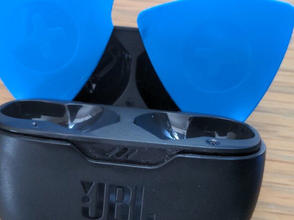

    • Slide the pick around the edge of the case until it reaches the back, next to the hinge part. You can apply more heat here if this is too difficult.
    • Repeat with a second opening pick, going round the other side. The second image shows what your case should now look like.

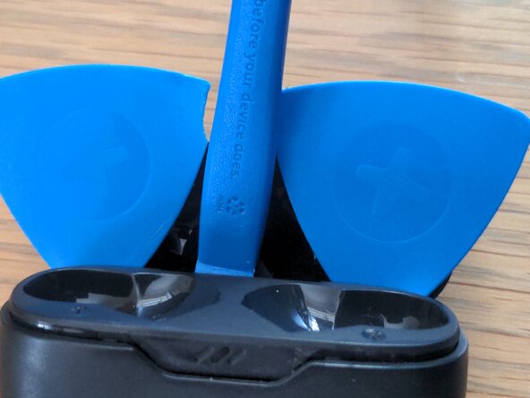

  3. JBL Wave Beam Case Disassembly, Lift out the internals: crwdns2935265:03crwdnd2935265:01crwdnd2935265:01crwdne2935265:0
    • Get an iFixit Plastic Lever Thingy™ and wedge it into the hinge area, as shown. Pull upwards to pop out the internals (as well as your picks - watch out!)
    • If this is too difficult, you might want to use a third pick, and pry around the area under the LED.

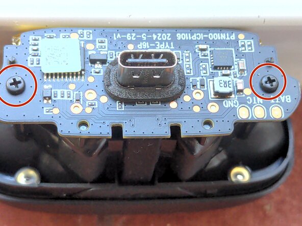

    • You should now have removed the outer case. Remove the two Phillips #0 screws next to the exposed USB port.
    • Pull the motherboard directly upwards. Be gentle here, as it is still connected to the glued-down battery

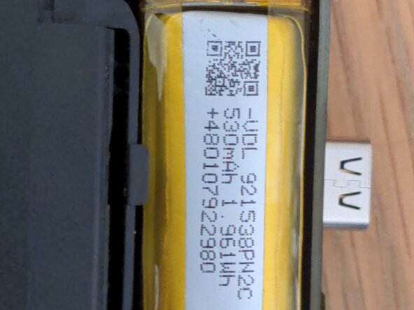

    • Use a plastic tool to pry out the battery, it is attached to the case with a sticky pad. If you have isopropyl alcohol, apply some underneath the battery to loosen the adhesive.

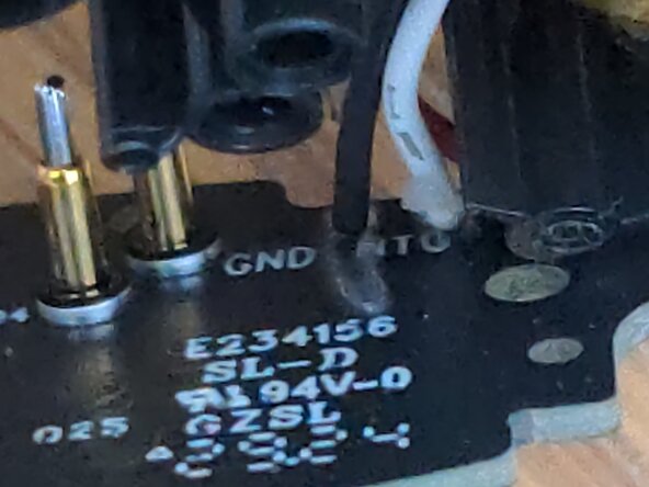

  5. JBL Wave Beam Case Disassembly, Desolder the battery: crwdns2935265:05crwdnd2935265:01crwdnd2935265:01crwdne2935265:0
    • The battery is connected to the motherboard with either 3 or 2 solder pads. Use a soldering iron and flux to remove all of them, being careful not to cause any shorts.
    • Solder the black and red wires of your new battery to GND and BATT on the motherboard, respectively. If there is a third wire (temperature sensor) solder it to the NTC pad.
    • Chip 1: ICP1106 power management from Shanghai Laiyuan electronics
    • Datasheet: https://icpow.com/Products/189.html
    • Chip 2: MC51F003A4A0Y microcontroller - used in soldering irons?
