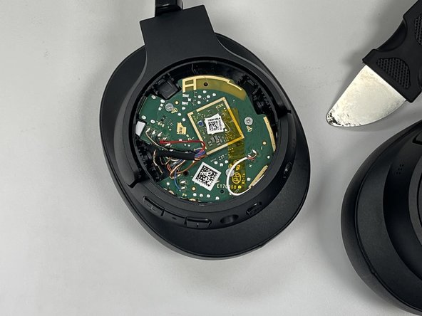

    • Insert your jimmy into the seam between the cap and the chassis.
  2. JBL Tune 770NC Headphone Buttons Replacement: crwdns2935265:02crwdnd2935265:01crwdnd2935265:02crwdne2935265:0 JBL Tune 770NC Headphone Buttons Replacement: crwdns2935265:02crwdnd2935265:02crwdnd2935265:02crwdne2935265:0
    • Pry around the perimeter of the cap until it fully releases.
    • Remove the cap.
  3. JBL Tune 770NC Headphone Buttons Replacement: crwdns2935265:03crwdnd2935265:01crwdnd2935265:01crwdne2935265:0
    • Use a Phillips screwdriver to remove the three screws that secure the motherboard.
  4. JBL Tune 770NC Headphone Buttons Replacement: crwdns2935265:04crwdnd2935265:01crwdnd2935265:02crwdne2935265:0 JBL Tune 770NC Headphone Buttons Replacement: crwdns2935265:04crwdnd2935265:02crwdnd2935265:02crwdne2935265:0
    • Gently move the motherboard out of the way, with care not to strain the attached cables.
  5. JBL Tune 770NC Headphone Buttons Replacement: crwdns2935265:05crwdnd2935265:01crwdnd2935265:02crwdne2935265:0 JBL Tune 770NC Headphone Buttons Replacement: crwdns2935265:05crwdnd2935265:02crwdnd2935265:02crwdne2935265:0
    • Use a jimmy to wiggle the button off the edge, then push the buttons inside of the headphone chassis.
    • Remove the buttons.
