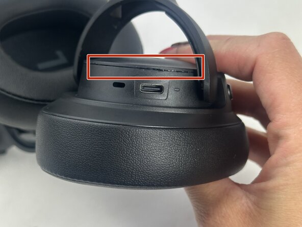

    • Power off the device and unplug any cables.
    • Place the headphones on a stable, flat surface.
    • Insert the Jimmy pry tool at a 30° angle into the seam between the ear cup and the plastic cap.
    • Pry gently but firmly to release the internal clips. You may need to try different spots around the seam for easier access.
    • Once the cap is removed, set it aside.
    • Keep track of any small plastic clips or parts that may come loose during prying

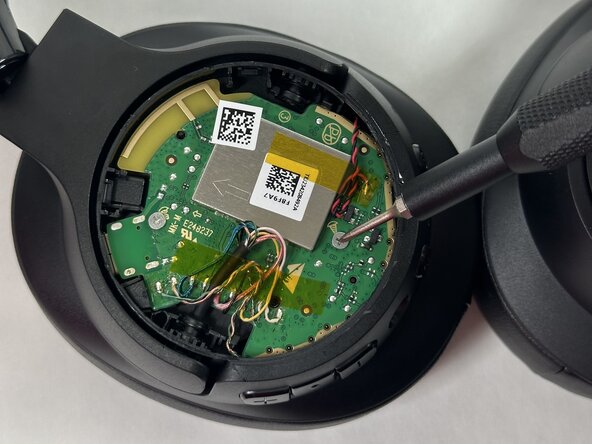

    • Identify the green circuit board this is the motherboard.
    • Remove the two 5.1 mm Phillips #0 screws securing the motherboard.
    • Set the screws aside in a labeled tray for easy reassembly.
    • Labeling screws by type and location helps ensure they return to the correct place
