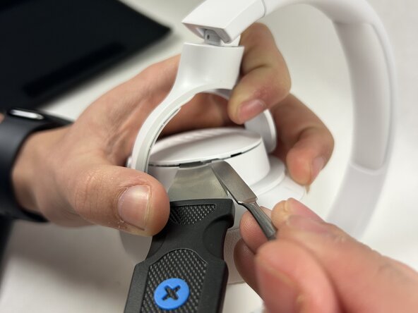

    • First step we will start by prying off the back of the right ear cup using the “jimmy” tool.
    • A slight amount of force will be needed to leverage the back off of its clips.

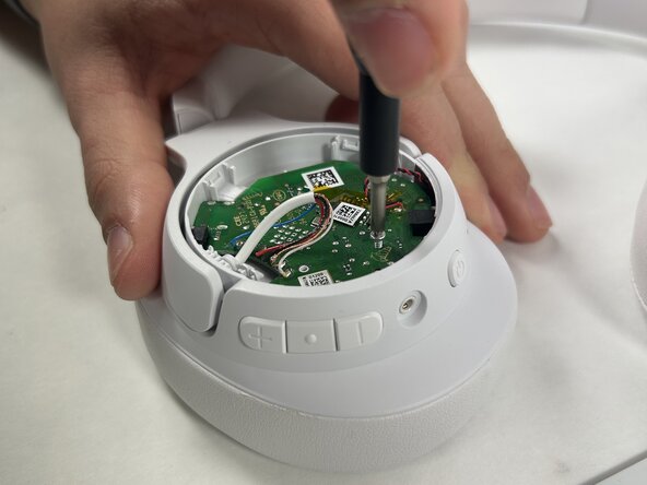

    • Next we continue by removing the screws while holding down the board and takeout the cover.

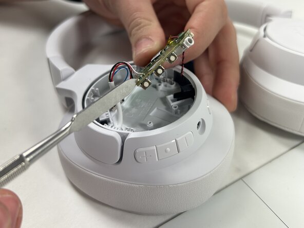

    • Back on the right side, gently flip the board to reveal the charging port.
    • Be careful to ensure you do not over extend the wires.
    • Set the board onto a comfortable position for the next step
  5. JBL Tune 720BT Charging Port Replacement: crwdns2935265:05crwdnd2935265:01crwdnd2935265:01crwdne2935265:0
    • Use a soldering iron to heat and remove the old port.
    • Solder the new charging port to the soldering points on the board. When you are done soldering, make sure to clean any leftover solder.
