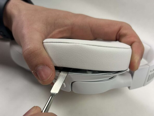

  1. JBL Tune 720 BT Headphones Right Speaker Driver Replacement, Ear Cup: crwdns2935265:01crwdnd2935265:01crwdnd2935265:02crwdne2935265:0 JBL Tune 720 BT Headphones Right Speaker Driver Replacement, Ear Cup: crwdns2935265:01crwdnd2935265:02crwdnd2935265:02crwdne2935265:0
    • Insert the Jimmy into the slit of the ear cup.
    • Insert the metal spudger with the Jimmy and use the spudger to pry the ear cup off.

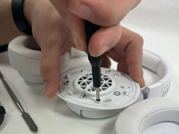

  2. JBL Tune 720 BT Headphones Right Speaker Driver Replacement, Right Speaker Driver: crwdns2935265:02crwdnd2935265:01crwdnd2935265:02crwdne2935265:0 JBL Tune 720 BT Headphones Right Speaker Driver Replacement, Right Speaker Driver: crwdns2935265:02crwdnd2935265:02crwdnd2935265:02crwdne2935265:0
    • Remove the three screws using a Phillips #0 screwdriver.
