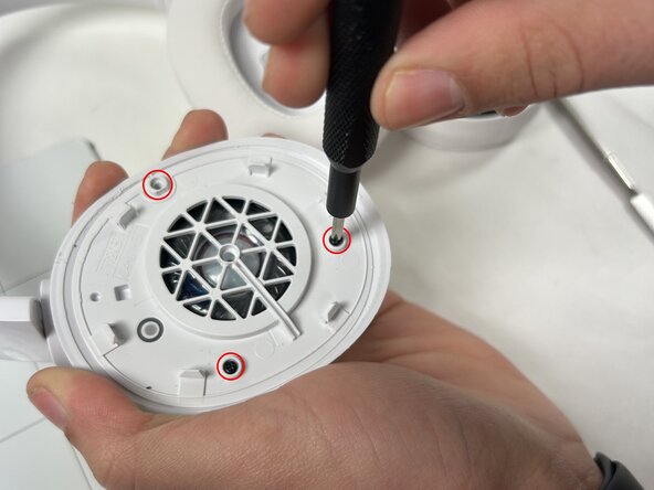

    • Remove the three screws using a Phillips #0 screwdriver.

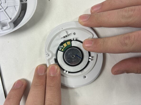

    • Use the Jimmy to pry out the white covering from the headphones.
  4. JBL Tune 720 BT Headphones Left Speaker Driver Replacement: crwdns2935265:04crwdnd2935265:01crwdnd2935265:02crwdne2935265:0 JBL Tune 720 BT Headphones Left Speaker Driver Replacement: crwdns2935265:04crwdnd2935265:02crwdnd2935265:02crwdne2935265:0
    • Use the Jimmy to pry out the speaker driver.
If you ever get stuck in reassembly, work in reverse order of how you took it apart!
