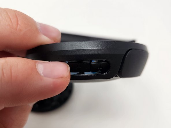

JBL Tune 510BT Volume Button Replacement
  1. JBL Tune 510BT Volume Button Replacement, Faceplate: crwdns2935265:01crwdnd2935265:01crwdnd2935265:02crwdne2935265:0 JBL Tune 510BT Volume Button Replacement, Faceplate: crwdns2935265:01crwdnd2935265:02crwdnd2935265:02crwdne2935265:0
    • Firmly grasp the earmuff and pull away from the center until the lip of the earmuff is disengaged.
    • Pull the earmuff towards the center of the headphones until it is free.
  2. JBL Tune 510BT Volume Button Replacement: crwdns2935265:02crwdnd2935265:01crwdnd2935265:02crwdne2935265:0 JBL Tune 510BT Volume Button Replacement: crwdns2935265:02crwdnd2935265:02crwdnd2935265:02crwdne2935265:0

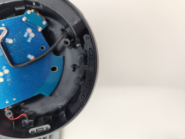

  3. JBL Tune 510BT Volume Button Replacement: crwdns2935265:03crwdnd2935265:01crwdnd2935265:01crwdne2935265:0
    • Carefully remove the faceplate by lifting it firmly.
    • Avoid rough movements, as there is a single thin wire connecting the faceplate to the internals.
    • If the repair is for the right-side driver, be mindful of the charging port, as the faceplate has a slot there for it. Lift the opposite end and back the port out.
    • To completely detach the faceplate, desolder the wires from the connections on the motherboard.

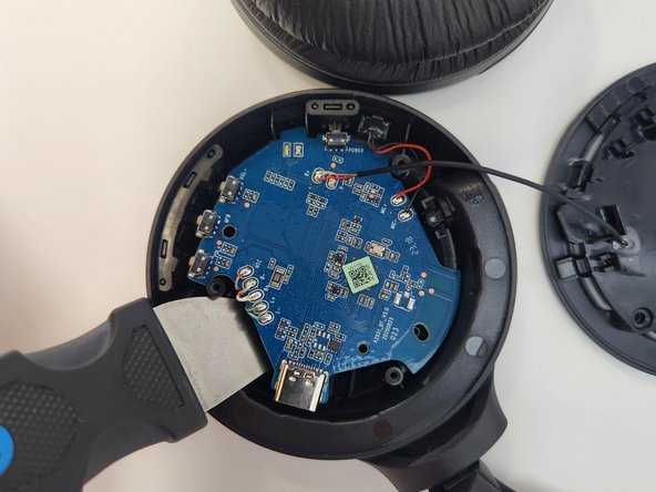

  4. JBL Tune 510BT Volume Button Replacement, Volume Button: crwdns2935265:04crwdnd2935265:01crwdnd2935265:02crwdne2935265:0 JBL Tune 510BT Volume Button Replacement, Volume Button: crwdns2935265:04crwdnd2935265:02crwdnd2935265:02crwdne2935265:0
    • Remove the 1 mm screw using a JIS #00 screwdriver.
    • Using your finger or a Jimmy, gently pry the circuit board from the casing, being careful to not pull too hard to dislodge the connected wires.
  5. JBL Tune 510BT Volume Button Replacement: crwdns2935265:05crwdnd2935265:01crwdnd2935265:03crwdne2935265:0 JBL Tune 510BT Volume Button Replacement: crwdns2935265:05crwdnd2935265:02crwdnd2935265:03crwdne2935265:0 JBL Tune 510BT Volume Button Replacement: crwdns2935265:05crwdnd2935265:03crwdnd2935265:03crwdne2935265:0
    • Gently push the damaged volume button from the outside towards the inner part of the headphone casing until it dislodges.
    • Replace it with the new button by connecting the tabs at the top and swinging the button into place.
