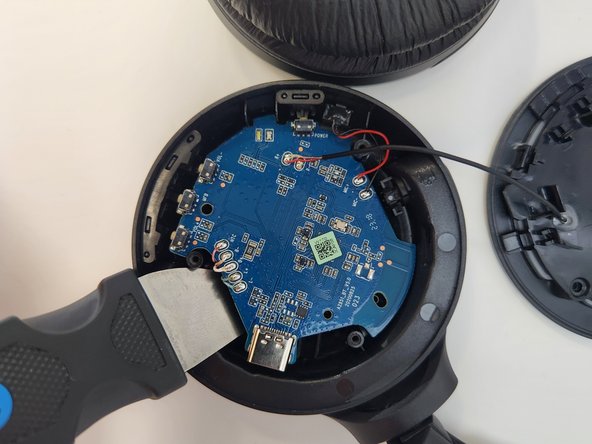

  4. JBL Tune 510BT Power Button Replacement, Power Button: crwdns2935265:04crwdnd2935265:01crwdnd2935265:02crwdne2935265:0 JBL Tune 510BT Power Button Replacement, Power Button: crwdns2935265:04crwdnd2935265:02crwdnd2935265:02crwdne2935265:0
    • Remove the 1 mm screw using a JIS #00 screwdriver.
    • Using your finger or a Jimmy, gently pry the circuit board from the casing, being careful to not pull too hard to dislodge the connected wires.

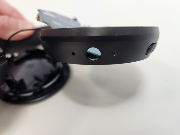

  5. JBL Tune 510BT Power Button Replacement: crwdns2935265:05crwdnd2935265:01crwdnd2935265:02crwdne2935265:0 JBL Tune 510BT Power Button Replacement: crwdns2935265:05crwdnd2935265:02crwdnd2935265:02crwdne2935265:0
    • Gently push the damaged power button from the outside towards the inner part of the headphone casing until it dislodges.
    • Replace it with the new button by connecting the tabs at the top and swinging the button into place.
