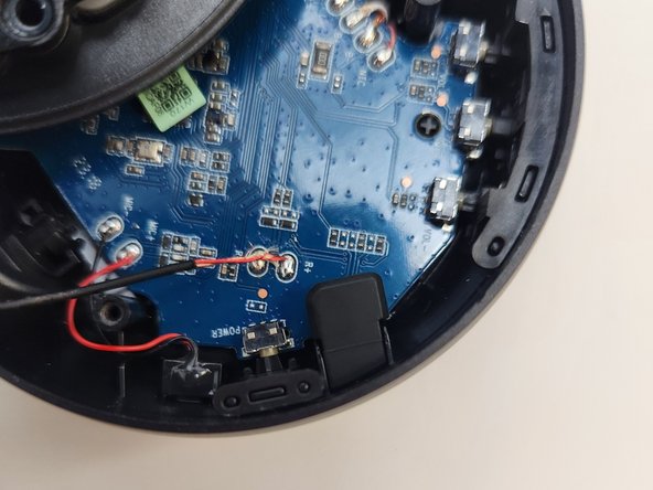

  3. JBL Tune 510BT LED and Refractor Replacement: crwdns2935265:03crwdnd2935265:01crwdnd2935265:01crwdne2935265:0
    • Carefully remove the faceplate by lifting it firmly.
    • Avoid rough movements, as there is a single thin wire connecting the faceplate to the internals.
    • If the repair is for the right-side driver, be mindful of the charging port, as the faceplate has a slot there for it. Lift the opposite end and back the port out.
    • To completely detach the faceplate, desolder the wires from the connections on the motherboard.

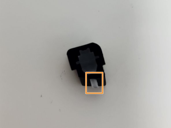

  4. JBL Tune 510BT LED and Refractor Replacement, LED and Refractor: crwdns2935265:04crwdnd2935265:01crwdnd2935265:03crwdne2935265:0 JBL Tune 510BT LED and Refractor Replacement, LED and Refractor: crwdns2935265:04crwdnd2935265:02crwdnd2935265:03crwdne2935265:0 JBL Tune 510BT LED and Refractor Replacement, LED and Refractor: crwdns2935265:04crwdnd2935265:03crwdnd2935265:03crwdne2935265:0
    • This is where you would find the rubber housing normally.
    • If the rubber housing is dislodged, which is fairly common, simply replace it in its correct orientation to its seating, being sure to place the indicated piece through the hole to the exterior of the headphones.

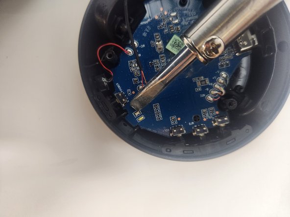

  5. JBL Tune 510BT LED and Refractor Replacement: crwdns2935265:05crwdnd2935265:01crwdnd2935265:02crwdne2935265:0 JBL Tune 510BT LED and Refractor Replacement: crwdns2935265:05crwdnd2935265:02crwdnd2935265:02crwdne2935265:0
    • Heat the small spots of solder where the two LED strips are on the circuit board with a soldering iron.
    • The yellow strip is the white LED, and the white strip is the red and blue LED. Make note of their orientation and positions.
    • Solder the new LEDs into position, making sure the contacts are solid.
