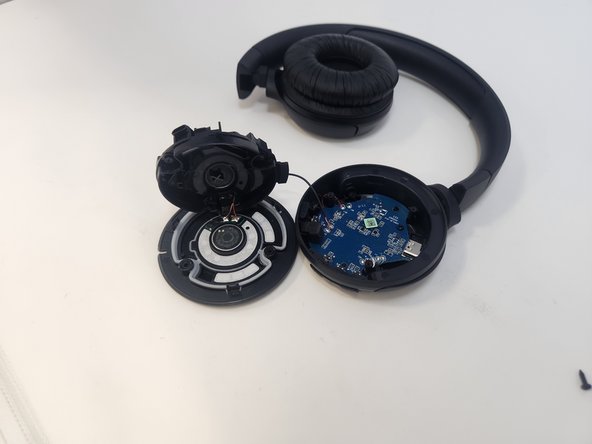

  3. JBL Tune 510BT Headphone Speaker Driver Replacement: crwdns2935265:03crwdnd2935265:01crwdnd2935265:01crwdne2935265:0
    • Carefully remove the faceplate by lifting it firmly.
    • Avoid rough movements, as there is a single thin wire connecting the faceplate to the internals.
    • If the repair is for the right-side driver, be mindful of the charging port, as the faceplate has a slot there for it. Lift the opposite end and back the port out.
    • To completely detach the faceplate, desolder the wires from the connections on the motherboard.

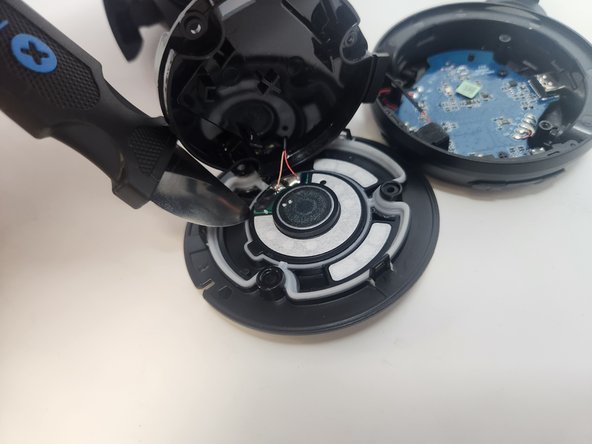

  4. JBL Tune 510BT Headphone Speaker Driver Replacement, Headphone Speaker Driver: crwdns2935265:04crwdnd2935265:01crwdnd2935265:03crwdne2935265:0 JBL Tune 510BT Headphone Speaker Driver Replacement, Headphone Speaker Driver: crwdns2935265:04crwdnd2935265:02crwdnd2935265:03crwdne2935265:0 JBL Tune 510BT Headphone Speaker Driver Replacement, Headphone Speaker Driver: crwdns2935265:04crwdnd2935265:03crwdnd2935265:03crwdne2935265:0
    • Pull each of the three pull tabs away from the center of the faceplate, disengaging them and exposing the back of the speaker driver.
    • Push a Jimmy or other pry tool gently between the driver and the grey spacer.
    • Lift gently until the driver is loose, being mindful not to damage the wires connecting to the driver.

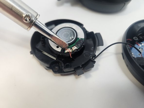

  5. JBL Tune 510BT Headphone Speaker Driver Replacement: crwdns2935265:05crwdnd2935265:01crwdnd2935265:02crwdne2935265:0 JBL Tune 510BT Headphone Speaker Driver Replacement: crwdns2935265:05crwdnd2935265:02crwdnd2935265:02crwdne2935265:0
    • Desolder the two wires from the driver carefully.
    • Orient your new driver and solder the wires to it, making sure to solder the wires to the correct terminals and confirming that the wires aren't crossed.
