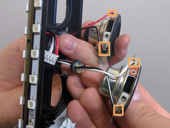

  11. JBL Pulse Speakers Replacement, Speakers: crwdns2935265:011crwdnd2935265:01crwdnd2935265:02crwdne2935265:0 JBL Pulse Speakers Replacement, Speakers: crwdns2935265:011crwdnd2935265:02crwdnd2935265:02crwdne2935265:0
    • Remove four black PH0 9mm screws.
    • The only thing still attaching the speakers is the wires to the soldering points. Cut wires at soldering points.
    • New speakers will have to be re-soldered to these wires.
