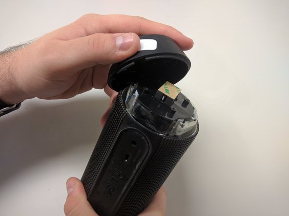

This guide is for replacing the outer casing of the JBL Pulse for when some kind of damage has occurred to the outside of the device.
    1. JBL Pulse Outer Casing Replacement, Button Board: crwdns2935265:01crwdnd2935265:01crwdnd2935265:01crwdne2935265:0
      • Use a plastic opening tool to pry around the edges of the circular rubber panel.
    2. JBL Pulse Outer Casing Replacement: crwdns2935265:02crwdnd2935265:01crwdnd2935265:01crwdne2935265:0
      • Once the edges are loose, pull off the rubber button panel completely.
      • New adhesive will have to be applied when reassembling.
    3. JBL Pulse Outer Casing Replacement: crwdns2935265:03crwdnd2935265:01crwdnd2935265:01crwdne2935265:0
      • Use your plastic opening tool to pry the button board loose by lifting the edges.
    4. JBL Pulse Outer Casing Replacement: crwdns2935265:04crwdnd2935265:01crwdnd2935265:01crwdne2935265:0
      • Lift the button board, exposing the attached cable.
    5. JBL Pulse Outer Casing Replacement: crwdns2935265:05crwdnd2935265:01crwdnd2935265:01crwdne2935265:0
      • Pull black piece on top of socket away from board to loosen, then detach the cable.

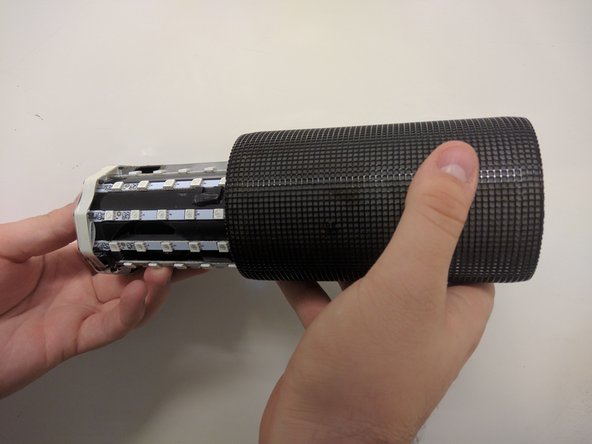

    1. JBL Pulse Outer Casing Replacement, Outer Casing: crwdns2935265:06crwdnd2935265:01crwdnd2935265:03crwdne2935265:0 JBL Pulse Outer Casing Replacement, Outer Casing: crwdns2935265:06crwdnd2935265:02crwdnd2935265:03crwdne2935265:0 JBL Pulse Outer Casing Replacement, Outer Casing: crwdns2935265:06crwdnd2935265:03crwdnd2935265:03crwdne2935265:0
      • Take out the four 9mm black PH0 screws from the top and bottom of the device.
      • Pull off cap by hand.
      • The outer casing can now be removed.
