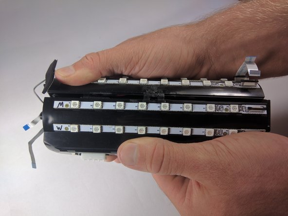

    1. JBL Pulse Motherboard Replacement, JBL Pulse LED Lights Disassembly: crwdns2935265:07crwdnd2935265:01crwdnd2935265:02crwdne2935265:0 JBL Pulse Motherboard Replacement, JBL Pulse LED Lights Disassembly: crwdns2935265:07crwdnd2935265:02crwdnd2935265:02crwdne2935265:0
      • Remove the tape around the cables on the top of the device.
      • Remove the cables by lifting up on the black bracket and then pulling the cable out.

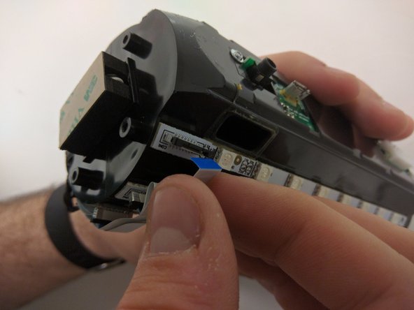

    1. JBL Pulse Motherboard Replacement, JBL Pulse Disassembly: crwdns2935265:08crwdnd2935265:01crwdnd2935265:01crwdne2935265:0
      • Remove two black 9mm PH0 screws from outside of inner casing on each side.

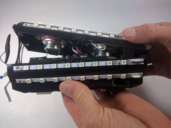

    2. JBL Pulse Motherboard Replacement: crwdns2935265:09crwdnd2935265:01crwdnd2935265:03crwdne2935265:0 JBL Pulse Motherboard Replacement: crwdns2935265:09crwdnd2935265:02crwdnd2935265:03crwdne2935265:0 JBL Pulse Motherboard Replacement: crwdns2935265:09crwdnd2935265:03crwdnd2935265:03crwdne2935265:0
      • Use your metal spudger to unhook the bracket holding the case together.
      • Pull apart the casing with your hands.

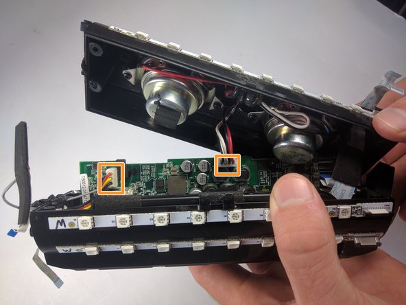

    3. JBL Pulse Motherboard Replacement: crwdns2935265:010crwdnd2935265:01crwdnd2935265:02crwdne2935265:0 JBL Pulse Motherboard Replacement: crwdns2935265:010crwdnd2935265:02crwdnd2935265:02crwdne2935265:0
      • Remove cables by pulling firmly.
    1. JBL Pulse Motherboard Replacement, Motherboard: crwdns2935265:011crwdnd2935265:01crwdnd2935265:01crwdne2935265:0
      • Once all of the cables are removed, grip the motherboard and slide it out.
