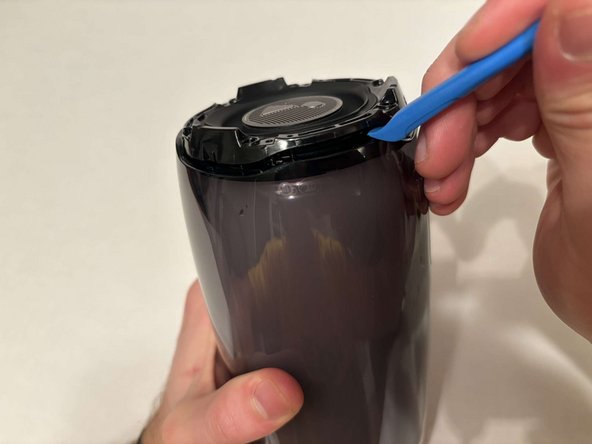

    • Remove each rubber end cap using a plastic pry tool.
    • Go around each end of the speaker slowly popping up a small section of the rubber cap until there is a gap on all sides.
    • Remove the top by hand.

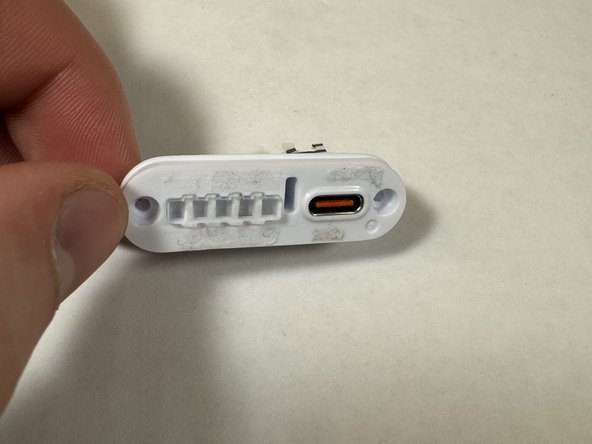

  3. JBL Pulse 4 Outside Casing Replacement: crwdns2935265:03crwdnd2935265:01crwdnd2935265:03crwdne2935265:0 JBL Pulse 4 Outside Casing Replacement: crwdns2935265:03crwdnd2935265:02crwdnd2935265:03crwdne2935265:0 JBL Pulse 4 Outside Casing Replacement: crwdns2935265:03crwdnd2935265:03crwdnd2935265:03crwdne2935265:0

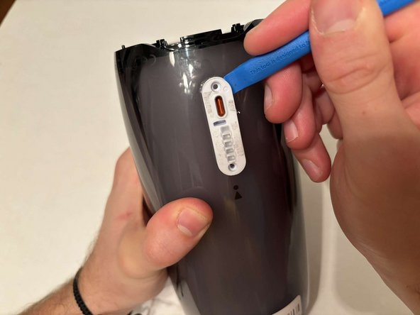

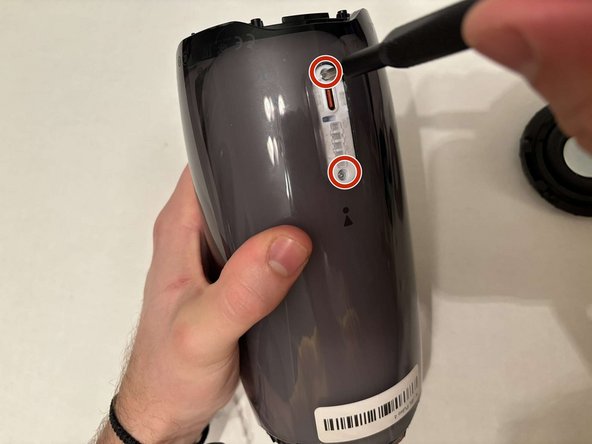

    • Remove the charging port cover using a plastic pry tool.
    • Remove the two 12.7 mm Phillips #1 screws.
    • Remove the charging port housing from the casing.
  4. JBL Pulse 4 Outside Casing Replacement: crwdns2935265:04crwdnd2935265:01crwdnd2935265:03crwdne2935265:0 JBL Pulse 4 Outside Casing Replacement: crwdns2935265:04crwdnd2935265:02crwdnd2935265:03crwdne2935265:0 JBL Pulse 4 Outside Casing Replacement: crwdns2935265:04crwdnd2935265:03crwdnd2935265:03crwdne2935265:0

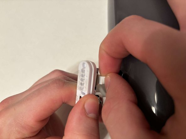

    • Disconnect the charging port connector by pulling the connector away from the port.
    • Disconnect the battery level indicator light by pulling the wire away from the lights.
  5. JBL Pulse 4 Outside Casing Replacement: crwdns2935265:05crwdnd2935265:01crwdnd2935265:02crwdne2935265:0 JBL Pulse 4 Outside Casing Replacement: crwdns2935265:05crwdnd2935265:02crwdnd2935265:02crwdne2935265:0

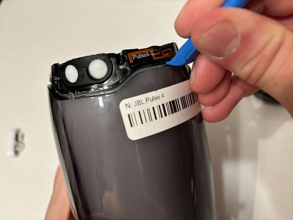

    • Flip the speaker to the other end.
    • Use a pry tool to pry between the casing of the speaker and the internals.
    • Go around the entirety of this end of the speaker slowly prying apart the two pieces.

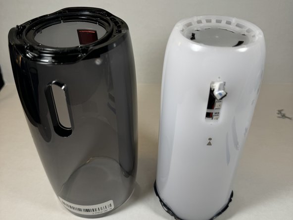

    • The casing is now fully detached from the internal components.
    • You can now replace the outer casing of the speaker.
