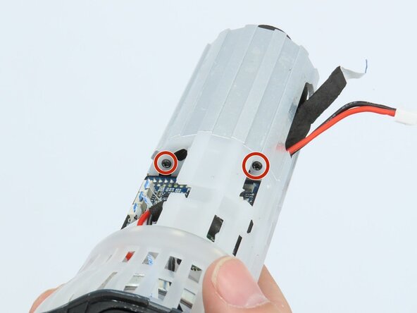

    • Remove the charging port cover using a plastic pry tool.
    • Remove the two 12.7 mm Phillips #1 screws.
    • Remove the charging port housing from the casing.

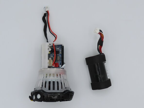

  15. JBL Pulse 4 Drivers Replacement, Battery: crwdns2935265:015crwdnd2935265:01crwdnd2935265:03crwdne2935265:0 JBL Pulse 4 Drivers Replacement, Battery: crwdns2935265:015crwdnd2935265:02crwdnd2935265:03crwdne2935265:0 JBL Pulse 4 Drivers Replacement, Battery: crwdns2935265:015crwdnd2935265:03crwdnd2935265:03crwdne2935265:0

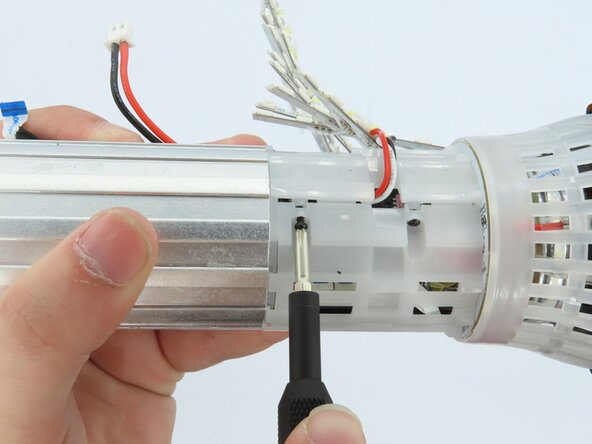

    • Remove the three black 5 mm screws using a Phillips #1 screwdriver.
  16. JBL Pulse 4 Drivers Replacement: crwdns2935265:016crwdnd2935265:01crwdnd2935265:02crwdne2935265:0 JBL Pulse 4 Drivers Replacement: crwdns2935265:016crwdnd2935265:02crwdnd2935265:02crwdne2935265:0
    • Unplug the cable connecting the battery to the motherboard.
  17. JBL Pulse 4 Drivers Replacement: crwdns2935265:017crwdnd2935265:01crwdnd2935265:02crwdne2935265:0 JBL Pulse 4 Drivers Replacement: crwdns2935265:017crwdnd2935265:02crwdnd2935265:02crwdne2935265:0
    • Feed the wire out of the central housing unit.
    • Pull the battery out of the central housing unit.

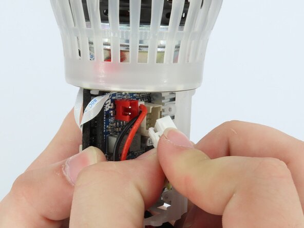

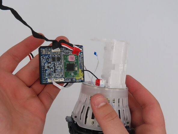

  19. JBL Pulse 4 Drivers Replacement, Motherboard: crwdns2935265:019crwdnd2935265:01crwdnd2935265:02crwdne2935265:0 JBL Pulse 4 Drivers Replacement, Motherboard: crwdns2935265:019crwdnd2935265:02crwdnd2935265:02crwdne2935265:0
    • Using the tweezers, gently unplug the three connections attached to the motherboard.
  20. JBL Pulse 4 Drivers Replacement: crwdns2935265:020crwdnd2935265:01crwdnd2935265:03crwdne2935265:0 JBL Pulse 4 Drivers Replacement: crwdns2935265:020crwdnd2935265:02crwdnd2935265:03crwdne2935265:0 JBL Pulse 4 Drivers Replacement: crwdns2935265:020crwdnd2935265:03crwdnd2935265:03crwdne2935265:0

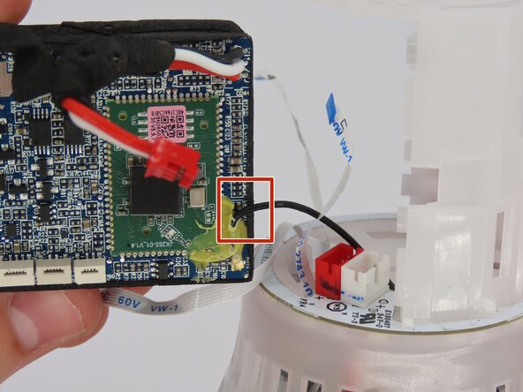

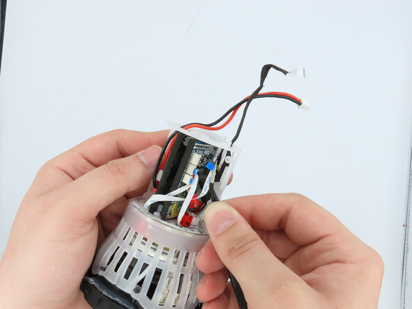

    • Pull the motherboard out of the frame.
    • The only connection the motherboard has to the frame now should be the soldered-on black wire.

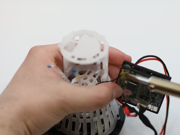

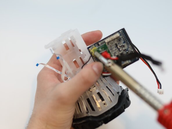

  21. JBL Pulse 4 Drivers Replacement: crwdns2935265:021crwdnd2935265:01crwdnd2935265:03crwdne2935265:0 JBL Pulse 4 Drivers Replacement: crwdns2935265:021crwdnd2935265:02crwdnd2935265:03crwdne2935265:0 JBL Pulse 4 Drivers Replacement: crwdns2935265:021crwdnd2935265:03crwdnd2935265:03crwdne2935265:0
    • Desolder the wire from the motherboard.
    • Remove the motherboard from the speaker.

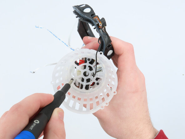

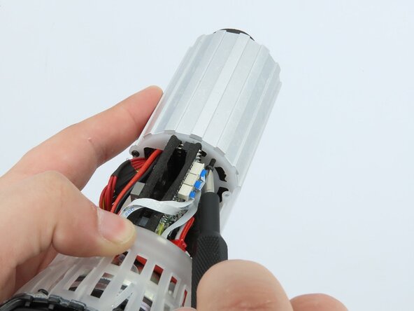

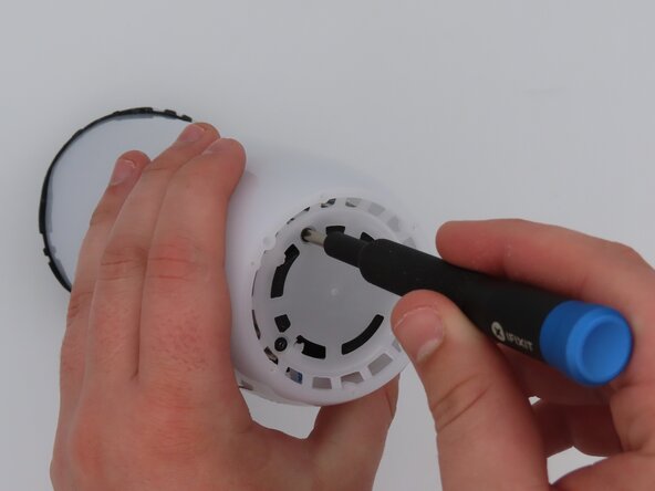

  22. JBL Pulse 4 Drivers Replacement, Drivers: crwdns2935265:022crwdnd2935265:01crwdnd2935265:02crwdne2935265:0 JBL Pulse 4 Drivers Replacement, Drivers: crwdns2935265:022crwdnd2935265:02crwdnd2935265:02crwdne2935265:0
    • Use a Phillips #00 screwdriver to remove the three 5 mm screws securing the plastic housing.
    • Remove the bumper assembly.

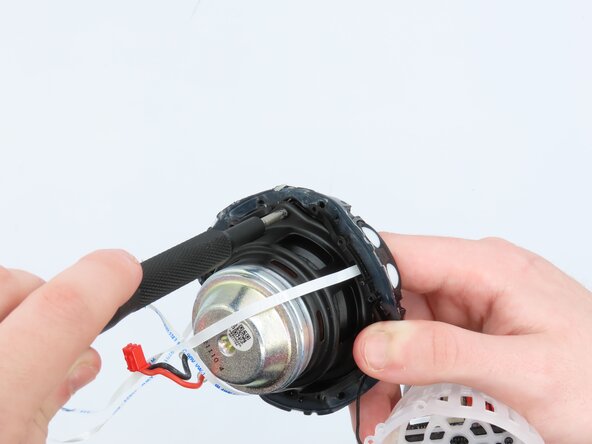

  24. JBL Pulse 4 Drivers Replacement: crwdns2935265:024crwdnd2935265:01crwdnd2935265:01crwdne2935265:0
    • Disconnect the connector attached to the driver by gently pulling it apart.
    • Caution: Avoid pulling on the wires directly to prevent damage to the connector or internal wiring.
  25. JBL Pulse 4 Drivers Replacement: crwdns2935265:025crwdnd2935265:01crwdnd2935265:02crwdne2935265:0 JBL Pulse 4 Drivers Replacement: crwdns2935265:025crwdnd2935265:02crwdnd2935265:02crwdne2935265:0
    • Remove the driver from the plastic housing by gently pulling them apart.
    • Hold both the driver and housing firmly during this process.
    • Use a Phillips #00 screwdriver to remove any screws securing the driver, if necessary.
    • Caution: Avoid putting pressure on the driver or its connections to prevent damage.
