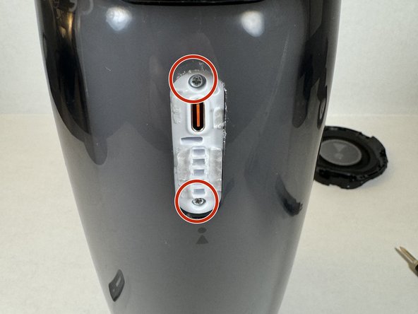

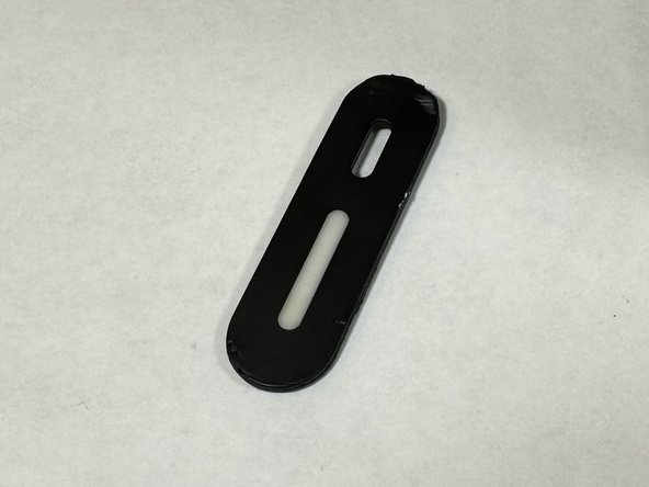

  3. JBL Pulse 4 Charging Port Replacement: crwdns2935265:03crwdnd2935265:01crwdnd2935265:03crwdne2935265:0 JBL Pulse 4 Charging Port Replacement: crwdns2935265:03crwdnd2935265:02crwdnd2935265:03crwdne2935265:0 JBL Pulse 4 Charging Port Replacement: crwdns2935265:03crwdnd2935265:03crwdnd2935265:03crwdne2935265:0
    • Carefully remove the charging port cover using a plastic pry tool.
    • Remove the two Phillips head screws.
    • The charging port assembly will be revealed.

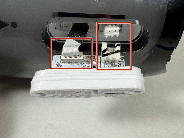

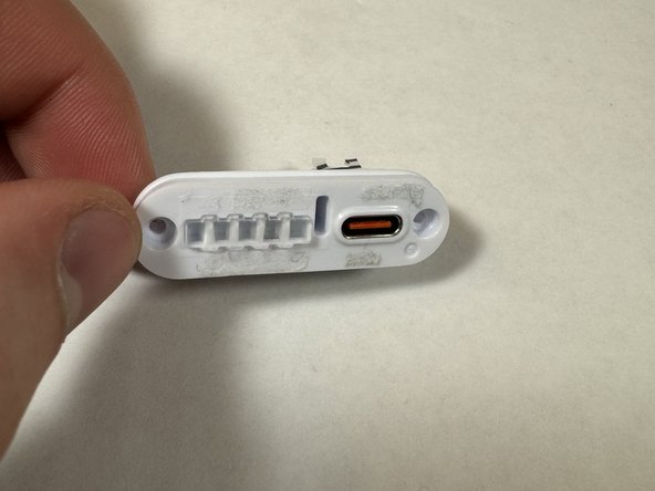

  4. JBL Pulse 4 Charging Port Replacement: crwdns2935265:04crwdnd2935265:01crwdnd2935265:03crwdne2935265:0 JBL Pulse 4 Charging Port Replacement: crwdns2935265:04crwdnd2935265:02crwdnd2935265:03crwdne2935265:0 JBL Pulse 4 Charging Port Replacement: crwdns2935265:04crwdnd2935265:03crwdnd2935265:03crwdne2935265:0
    • Pull the charging port assembly out of the casing.
    • Be careful and don't remove the assembly fully to avoid damaging the wires.
    • Carefully disconnect the two wires attached to the assembly.
  5. JBL Pulse 4 Charging Port Replacement: crwdns2935265:05crwdnd2935265:01crwdnd2935265:01crwdne2935265:0
    • Now you can reassemble the speaker reversing the steps provided to take it apart.
