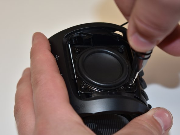

  16. JBL Pulse 3 Speaker Replacement, Speaker: crwdns2935265:017crwdnd2935265:01crwdnd2935265:02crwdne2935265:0 JBL Pulse 3 Speaker Replacement, Speaker: crwdns2935265:017crwdnd2935265:02crwdnd2935265:02crwdne2935265:0
    • Using a Phillips #2 screwdriver, remove the four 10mm screws on the corner of the speaker on the side of the base of the JBL Pulse 3.
  17. JBL Pulse 3 Speaker Replacement: crwdns2935265:018crwdnd2935265:01crwdnd2935265:02crwdne2935265:0 JBL Pulse 3 Speaker Replacement: crwdns2935265:018crwdnd2935265:02crwdnd2935265:02crwdne2935265:0
    • Pull out the speaker and cut the black and red wire with wire cutters. The speaker should now be removed from the JBL Pulse 3.
Note: To finish replacing the speaker, you must solder both wires back on to the new speaker.
