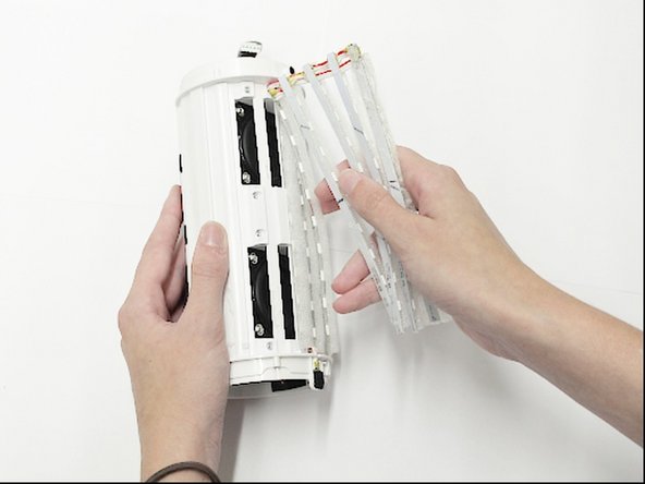

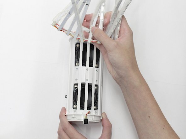

  16. JBL Pulse 2 Speaker Replacement, Speaker: crwdns2935265:016crwdnd2935265:01crwdnd2935265:03crwdne2935265:0 JBL Pulse 2 Speaker Replacement, Speaker: crwdns2935265:016crwdnd2935265:02crwdnd2935265:03crwdne2935265:0 JBL Pulse 2 Speaker Replacement, Speaker: crwdns2935265:016crwdnd2935265:03crwdnd2935265:03crwdne2935265:0
    • Remove the LED strips from the outside of the white plastic casing.

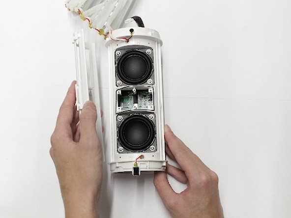

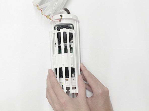

  17. JBL Pulse 2 Speaker Replacement: crwdns2935265:017crwdnd2935265:01crwdnd2935265:03crwdne2935265:0 JBL Pulse 2 Speaker Replacement: crwdns2935265:017crwdnd2935265:02crwdnd2935265:03crwdne2935265:0 JBL Pulse 2 Speaker Replacement: crwdns2935265:017crwdnd2935265:03crwdnd2935265:03crwdne2935265:0
    • Use the Phillips #1 screwdriver to remove the ten 9.5mm screws that hold the cage in place.
    • Lift the cage off to access the internal components.

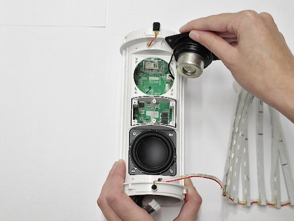

  18. JBL Pulse 2 Speaker Replacement: crwdns2935265:018crwdnd2935265:01crwdnd2935265:02crwdne2935265:0 JBL Pulse 2 Speaker Replacement: crwdns2935265:018crwdnd2935265:02crwdnd2935265:02crwdne2935265:0
    • Use the Phillips #1 screwdriver to remove the eight 6.4mm screws that hold the speakers in place.
    • Partially remove the speakers so that you can access the components underneath them.
  19. JBL Pulse 2 Speaker Replacement: crwdns2935265:019crwdnd2935265:01crwdnd2935265:02crwdne2935265:0 JBL Pulse 2 Speaker Replacement: crwdns2935265:019crwdnd2935265:02crwdnd2935265:02crwdne2935265:0
    • Use the straight tweezers to disconnect the speakers from the motherboard.
    • Fully remove the speakers once they are disconnected from the motherboard.
