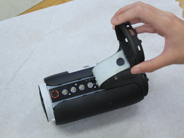

  2. JBL Pulse 2 Button Circuit Board Replacement: crwdns2935265:02crwdnd2935265:01crwdnd2935265:01crwdne2935265:0
    • Remove the four 4.8mm Phillips #1 screws from each end of the device with the Phillips head screwdriver.
    • Lift the end pieces off of the device.
  3. JBL Pulse 2 Button Circuit Board Replacement: crwdns2935265:03crwdnd2935265:01crwdnd2935265:01crwdne2935265:0
    • Remove the four 9.5mm Phillips #1 screws from each end of the device.

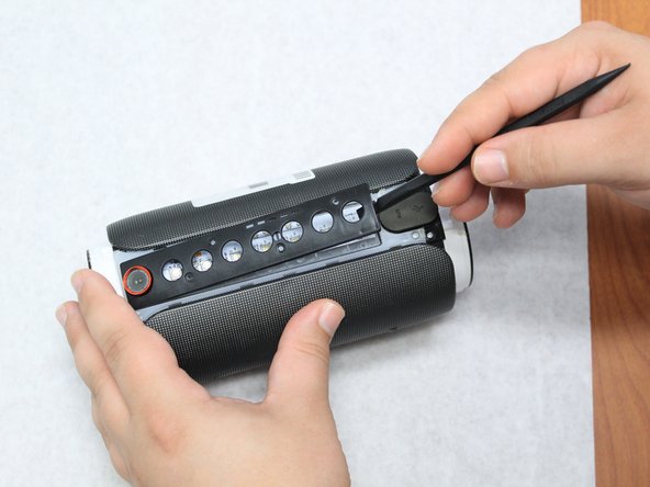

  4. JBL Pulse 2 Button Circuit Board Replacement: crwdns2935265:04crwdnd2935265:01crwdnd2935265:02crwdne2935265:0 JBL Pulse 2 Button Circuit Board Replacement: crwdns2935265:04crwdnd2935265:02crwdnd2935265:02crwdne2935265:0
    • Peel one end off and slowly draw it across the length of the device until you get to the other side.

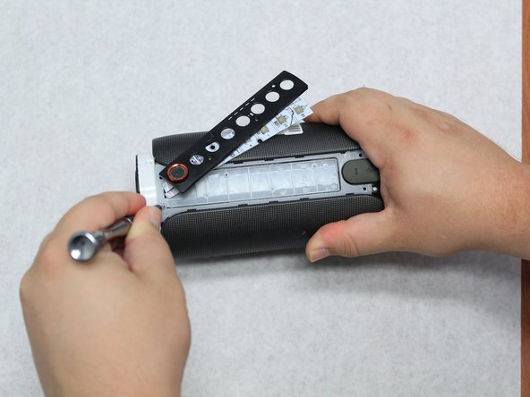

  5. JBL Pulse 2 Button Circuit Board Replacement: crwdns2935265:05crwdnd2935265:01crwdnd2935265:03crwdne2935265:0 JBL Pulse 2 Button Circuit Board Replacement: crwdns2935265:05crwdnd2935265:02crwdnd2935265:03crwdne2935265:0 JBL Pulse 2 Button Circuit Board Replacement: crwdns2935265:05crwdnd2935265:03crwdnd2935265:03crwdne2935265:0
    • Remove the four 7.9mm Phillips #1 screws along the black centerpiece of the device between the camera and the auxiliary port.
    • Lift up the casing and circuit board but do not try and remove the ribbon wires.
