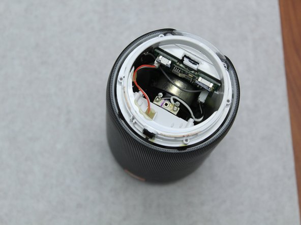

    • Remove the rubber rings from either end of the device.
    • If there is difficulty in lifting the rings from the device, use the metal spudger.
  2. JBL Pulse 2 Battery Replacement: crwdns2935265:02crwdnd2935265:01crwdnd2935265:01crwdne2935265:0
    • Remove the four 4.8mm Phillips #1 screws from each end of the device with the Phillips head screwdriver.
    • Lift the end pieces off of the device.

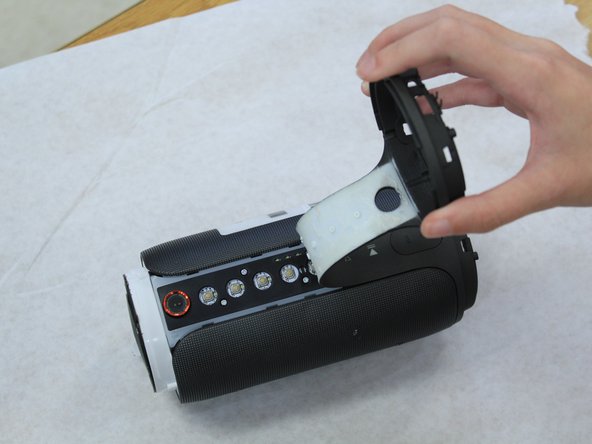

  4. JBL Pulse 2 Battery Replacement: crwdns2935265:04crwdnd2935265:01crwdnd2935265:02crwdne2935265:0 JBL Pulse 2 Battery Replacement: crwdns2935265:04crwdnd2935265:02crwdnd2935265:02crwdne2935265:0
    • Peel one end off and slowly draw it across the length of the device until you get to the other side.

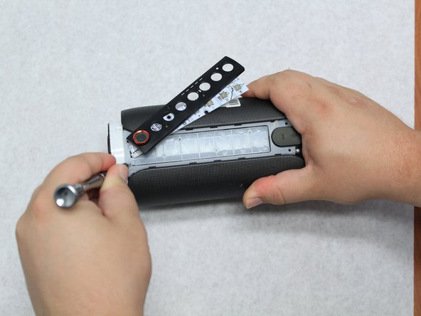

    • Remove the four 7.9mm Phillips #1 screws around the edges of the center piece.
    • Slide the outer casing off away from the auxiliary and micro USB port.

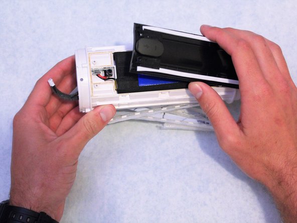

  14. JBL Pulse 2 Battery Replacement: crwdns2935265:014crwdnd2935265:01crwdnd2935265:02crwdne2935265:0 JBL Pulse 2 Battery Replacement: crwdns2935265:014crwdnd2935265:02crwdnd2935265:02crwdne2935265:0

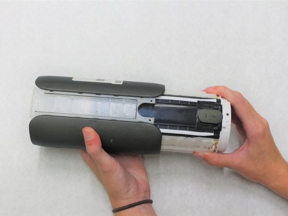

    • Lift the black centerpiece off with the metal spudger to reveal the battery underneath.
  15. JBL Pulse 2 Battery Replacement: crwdns2935265:015crwdnd2935265:01crwdnd2935265:01crwdne2935265:0
    • Use a hot air gun to soften the hot glue in order to fully remove the battery.
