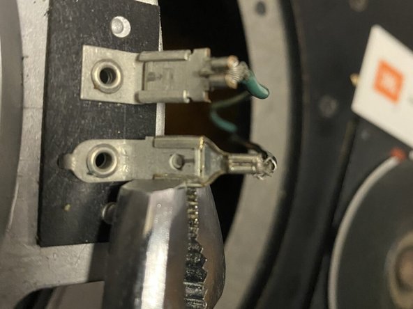

    • Unlatch the green wire by pulling on the terminal connector and not the wire.
  4. JBL L26 Speaker Replacement: crwdns2935265:04crwdnd2935265:01crwdnd2935265:02crwdne2935265:0 JBL L26 Speaker Replacement: crwdns2935265:04crwdnd2935265:02crwdnd2935265:02crwdne2935265:0
    • Use a small prying tool to pry the terminal connector off of the tap.
    • After you unlatched both edges, pull the black wire out.

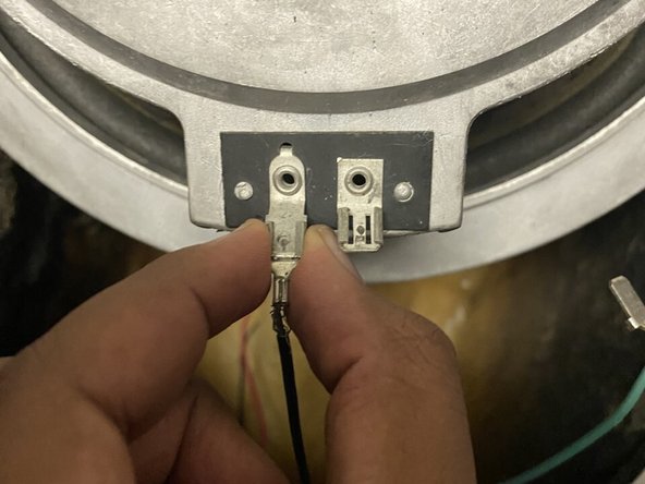

    • Get your replacement speaker and connect the green wire by pushing the terminal connector onto the tap.
  6. JBL L26 Speaker Replacement: crwdns2935265:06crwdnd2935265:01crwdnd2935265:02crwdne2935265:0 JBL L26 Speaker Replacement: crwdns2935265:06crwdnd2935265:02crwdnd2935265:02crwdne2935265:0
    • Connect the black wire by attaching the terminal connector onto the tap.
    • Use a clamping tool to clip the edges toward the tap.
    • Be careful not to clamp too hard so you don't damage the tap.
