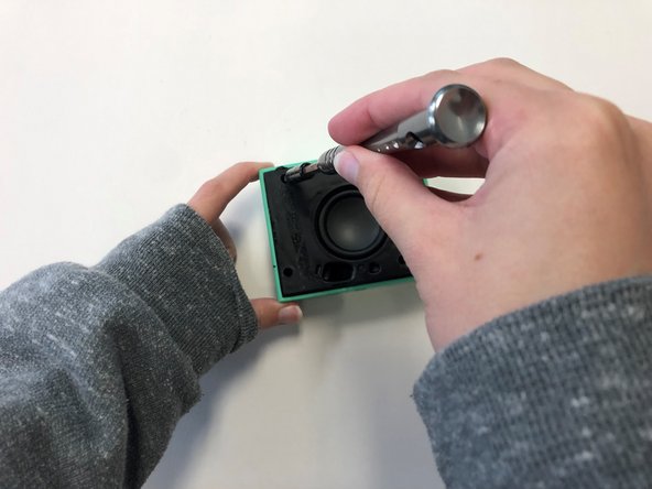

  4. JBL Go Woofer Replacement, Woofer: crwdns2935265:04crwdnd2935265:01crwdnd2935265:02crwdne2935265:0 JBL Go Woofer Replacement, Woofer: crwdns2935265:04crwdnd2935265:02crwdnd2935265:02crwdne2935265:0
    • Once the front cover is removed, use a T6 screwdriver head to remove the four 9 mm screws on the black cover.
