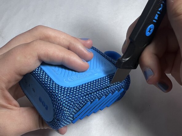

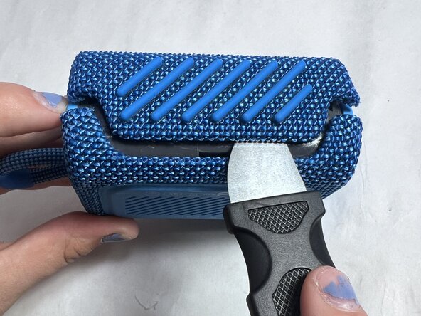

    • Using an iFixit Opening Pick or a Jimmy, pry along the seam between the rubber outer layer and the hard shell.

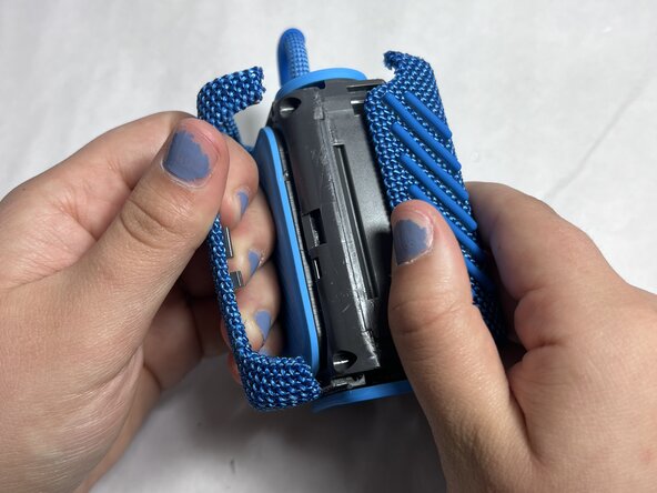

    • Work your way around the edges until the shell loosens and can be fully removed.
  2. JBL Go 3 Grille Replacement: crwdns2935265:02crwdnd2935265:01crwdnd2935265:03crwdne2935265:0 JBL Go 3 Grille Replacement: crwdns2935265:02crwdnd2935265:02crwdnd2935265:03crwdne2935265:0 JBL Go 3 Grille Replacement: crwdns2935265:02crwdnd2935265:03crwdnd2935265:03crwdne2935265:0
    • Once the shell is loosened on all sides, gently lift and remove it completely.

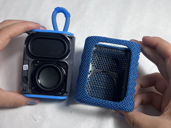

    • Align the new shell with the speaker’s body, making sure all edges are properly positioned.
    • Press firmly around the edges until the shell snaps securely into place.
To reassemble your device, follow these steps in reverse order.
