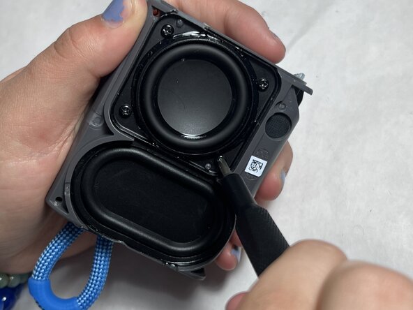

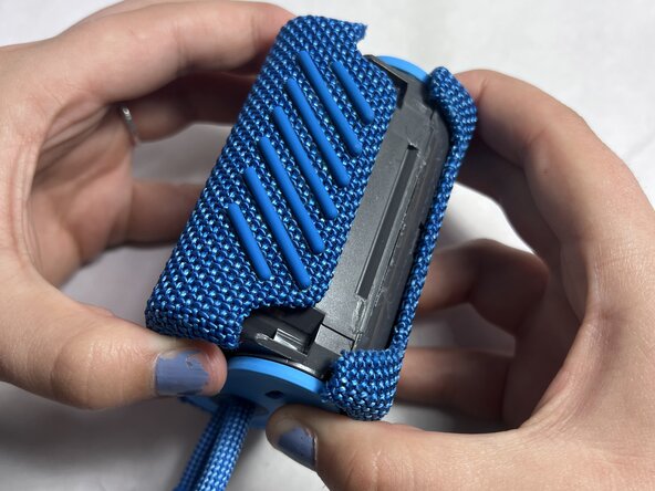

    • Use a Jimmy to remove the hard shell, working around the sides of the mesh cover.
    • Finally, unscrew the internal screws and gently lift off the back panel.

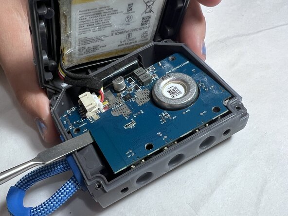

  2. JBL Go 3 Charging Port Replacement: crwdns2935265:02crwdnd2935265:01crwdnd2935265:02crwdne2935265:0 JBL Go 3 Charging Port Replacement: crwdns2935265:02crwdnd2935265:02crwdnd2935265:02crwdne2935265:0
    • Locate the charger port on the circuit board.
    • Carefully desolder the old port. If necessary, use an iFixit Opening Tool to gently dislodge and remove it.

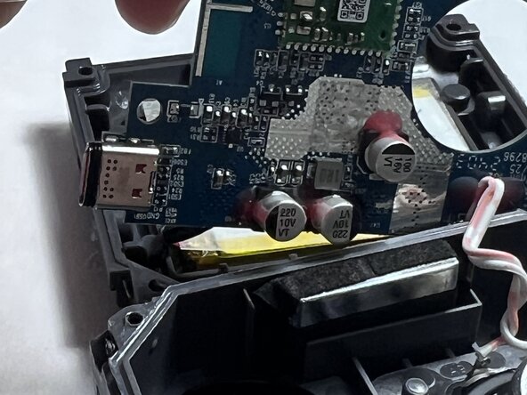

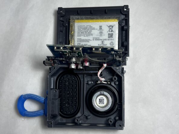

  3. JBL Go 3 Charging Port Replacement: crwdns2935265:03crwdnd2935265:01crwdnd2935265:03crwdne2935265:0 JBL Go 3 Charging Port Replacement: crwdns2935265:03crwdnd2935265:02crwdnd2935265:03crwdne2935265:0 JBL Go 3 Charging Port Replacement: crwdns2935265:03crwdnd2935265:03crwdnd2935265:03crwdne2935265:0
    • Locate the charging port, typically mounted on a small PCB (printed circuit board).
    • Take a picture and make a detailed note of all connections.
    • Carefully remove the charging port using an iFixit Opening Tool if Necessary.
    • Test the charging functionality before fully reassembling the device.
To reassemble your device, carefully place the new charging port and follow the instructions in reverse order.
