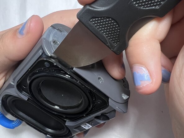

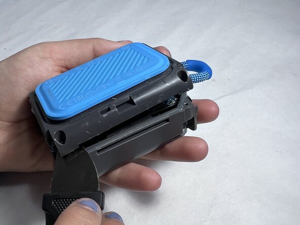

    • Use a Jimmy or opening pick to gently lift one corner of the fabric mesh, then carefully remove the entire fabric and shell.
    • Insert the Jimmy along the seam and gently pry open the housing.
    • Work your way around the speaker, unclipping the internal latches as you go.

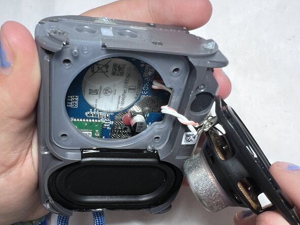

  2. JBL Go 3 Battery Replacement: crwdns2935265:02crwdnd2935265:01crwdnd2935265:03crwdne2935265:0 JBL Go 3 Battery Replacement: crwdns2935265:02crwdnd2935265:02crwdnd2935265:03crwdne2935265:0 JBL Go 3 Battery Replacement: crwdns2935265:02crwdnd2935265:03crwdnd2935265:03crwdne2935265:0
    • Around the rubber circle, you’ll find four small screws.
    • Use a screwdriver to remove the screws.
    • Then gently use a Jimmy to open the speaker’s housing.

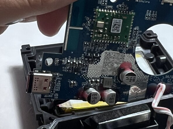

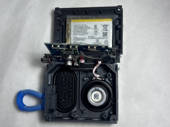

  3. JBL Go 3 Battery Replacement: crwdns2935265:03crwdnd2935265:01crwdnd2935265:03crwdne2935265:0 JBL Go 3 Battery Replacement: crwdns2935265:03crwdnd2935265:02crwdnd2935265:03crwdne2935265:0 JBL Go 3 Battery Replacement: crwdns2935265:03crwdnd2935265:03crwdnd2935265:03crwdne2935265:0
    • Unscrew the motherboard to access the battery.
    • Locate the battery, it’s usually wrapped in black or silver and connected to the mainboard by a small cable.
    • Carefully disconnect the battery connector from the circuit board.
    • Remove the old battery, replace it with the new one and reconnect the cable securely.
    • Close the housing, screw everything back in place, and reattach the fabric mesh.
