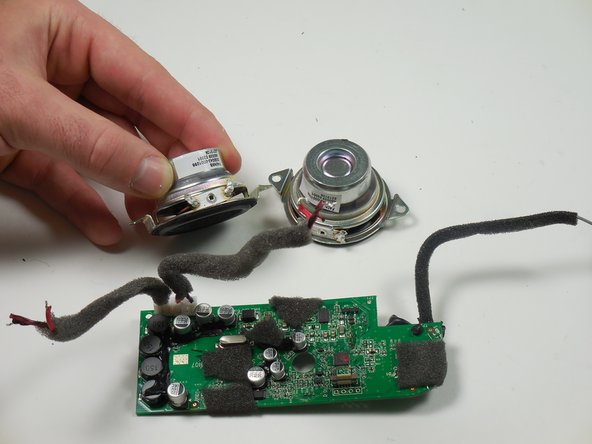

  7. JBL Flip Speaker Replacement, Speaker: crwdns2935265:07crwdnd2935265:01crwdnd2935265:03crwdne2935265:0 JBL Flip Speaker Replacement, Speaker: crwdns2935265:07crwdnd2935265:02crwdnd2935265:03crwdne2935265:0 JBL Flip Speaker Replacement, Speaker: crwdns2935265:07crwdnd2935265:03crwdnd2935265:03crwdne2935265:0
    • Remove screws that hold the plastic L-pipe in place.
  8. JBL Flip Speaker Replacement: crwdns2935265:08crwdnd2935265:01crwdnd2935265:02crwdne2935265:0 JBL Flip Speaker Replacement: crwdns2935265:08crwdnd2935265:02crwdnd2935265:02crwdne2935265:0
    • Remove L-pipe.
    • Remove two screws on each speaker.
    • Remove speakers.

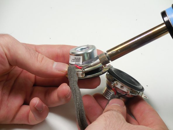

  9. JBL Flip Speaker Replacement: crwdns2935265:09crwdnd2935265:01crwdnd2935265:03crwdne2935265:0 JBL Flip Speaker Replacement: crwdns2935265:09crwdnd2935265:02crwdnd2935265:03crwdne2935265:0 JBL Flip Speaker Replacement: crwdns2935265:09crwdnd2935265:03crwdnd2935265:03crwdne2935265:0
    • Take a soldering iron to the two solders, one for each cable.
    • Soldering iron will be very hot.
    • Once the soldering has melted, remove each wire from the speaker.
