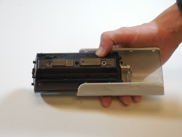

    • Pry the four tabs on each side of the speaker cover (8 tabs total).
    • Pry the two tabs on each end to remove the cover (4 tabs total).
    • Slide speaker out of metal speaker cover.
  6. JBL Flip Bluetooth U.FL Antenna Connector Replacement: crwdns2935265:06crwdnd2935265:01crwdnd2935265:03crwdne2935265:0 JBL Flip Bluetooth U.FL Antenna Connector Replacement: crwdns2935265:06crwdnd2935265:02crwdnd2935265:03crwdne2935265:0 JBL Flip Bluetooth U.FL Antenna Connector Replacement: crwdns2935265:06crwdnd2935265:03crwdnd2935265:03crwdne2935265:0
    • Remove 5mm screw in the middle of the back of the device with a size 2 ph screw driver.
    • Unscrew the two 5mm screws on each side using a size 2 ph screwdriver.
    • Open the speaker.

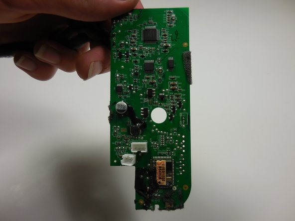

    • Disconnect all cables that are attached to the motherboard so that it resembles the step picture.
    • Make sure that the battery is turned off before removing cables.
  9. JBL Flip Bluetooth U.FL Antenna Connector Replacement: crwdns2935265:09crwdnd2935265:01crwdnd2935265:01crwdne2935265:0
    • Locate the underside of the motherboard, where the square U.FL antenna connector is.
  10. JBL Flip Bluetooth U.FL Antenna Connector Replacement: crwdns2935265:010crwdnd2935265:01crwdnd2935265:01crwdne2935265:0
    • Use the soldering iron to desolder the U.FL antenna connector. You might need to use a desoldering braid wire to remove the excess of solder.
    • Soldering iron will be very hot.
    • Clean the PCB pads of any excess of solder with the soldering braid wire before continuing.
    • Place the new U.FL connector on the pads where the desoldered connector was. Make sure the orientation of the connector is the same as before.
    • Solder the new U.FL connector to the PCB. Avoid exessive heat and/or prolongated soldering time during this step.
Be careful when connecting again the mini coaxial cable to the just replaced U.FL antenna connector, so it does not get damaged again.
