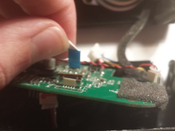

    1. JBL Flip Battery Replacement, Battery: crwdns2935265:07crwdnd2935265:01crwdnd2935265:02crwdne2935265:0 JBL Flip Battery Replacement, Battery: crwdns2935265:07crwdnd2935265:02crwdnd2935265:02crwdne2935265:0
      • Slowly peel the motherboard away from the black glue on the underside.
      • Make sure the battery below the motherboard is turned off before proceeding.
    2. JBL Flip Battery Replacement: crwdns2935265:08crwdnd2935265:01crwdnd2935265:02crwdne2935265:0 JBL Flip Battery Replacement: crwdns2935265:08crwdnd2935265:02crwdnd2935265:02crwdne2935265:0
      • Push brown tab up and gently pull connector out.
    3. JBL Flip Battery Replacement: crwdns2935265:09crwdnd2935265:01crwdnd2935265:03crwdne2935265:0 JBL Flip Battery Replacement: crwdns2935265:09crwdnd2935265:02crwdnd2935265:03crwdne2935265:0 JBL Flip Battery Replacement: crwdns2935265:09crwdnd2935265:03crwdnd2935265:03crwdne2935265:0
      • Remove the first two connectors on the underside of the motherboard.
    4. JBL Flip Battery Replacement: crwdns2935265:010crwdnd2935265:01crwdnd2935265:03crwdne2935265:0 JBL Flip Battery Replacement: crwdns2935265:010crwdnd2935265:02crwdnd2935265:03crwdne2935265:0 JBL Flip Battery Replacement: crwdns2935265:010crwdnd2935265:03crwdnd2935265:03crwdne2935265:0
      • Remove last connector.
      • Remove battery and replace.
