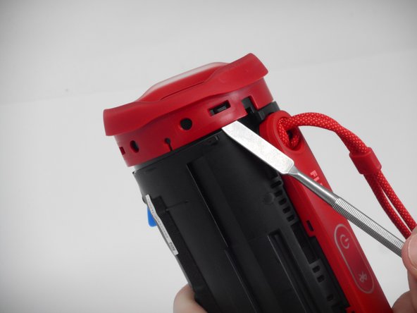

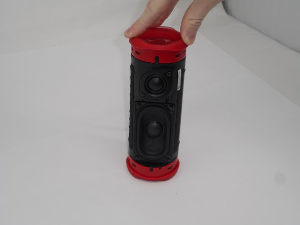

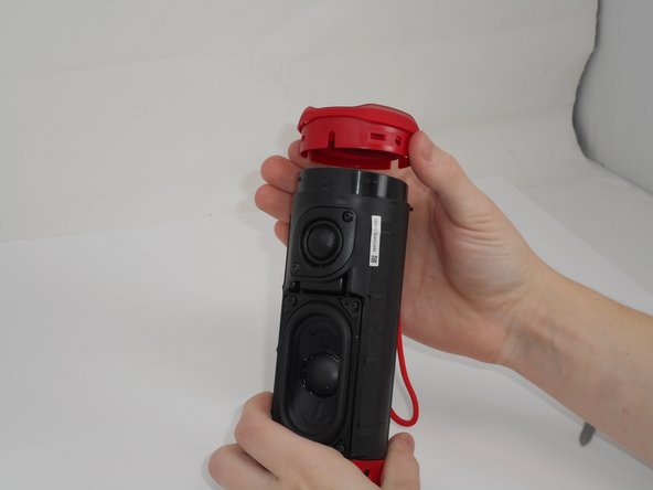

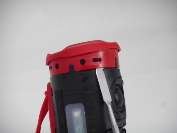

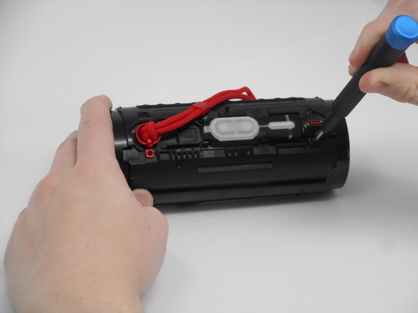

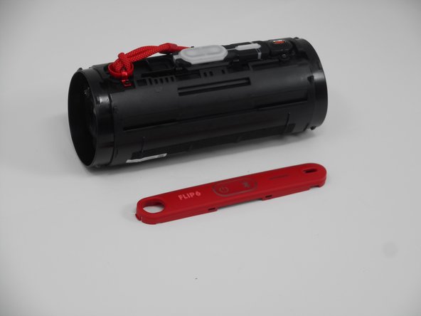

    • Using the iFixit opening tool, pry up on the button side of the slot on the case until the clips release.
  2. JBL Flip 6 Motherboard Replacement: crwdns2935265:02crwdnd2935265:01crwdnd2935265:02crwdne2935265:0 JBL Flip 6 Motherboard Replacement: crwdns2935265:02crwdnd2935265:02crwdnd2935265:02crwdne2935265:0
    • Now that the gap is larger, using the same tool, pry up on the other side until the clips release.
  3. JBL Flip 6 Motherboard Replacement: crwdns2935265:03crwdnd2935265:01crwdnd2935265:03crwdne2935265:0 JBL Flip 6 Motherboard Replacement: crwdns2935265:03crwdnd2935265:02crwdnd2935265:03crwdne2935265:0 JBL Flip 6 Motherboard Replacement: crwdns2935265:03crwdnd2935265:03crwdnd2935265:03crwdne2935265:0
    • With all clips released, slide the case off longways.
    • You may need to spread it a bit with your hands so that the clips do not become caught on the end pieces.

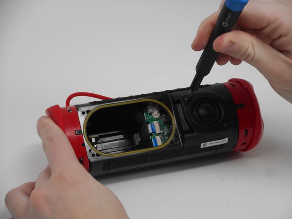

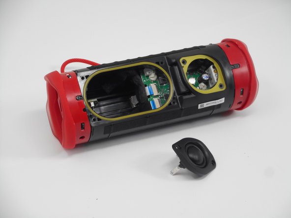

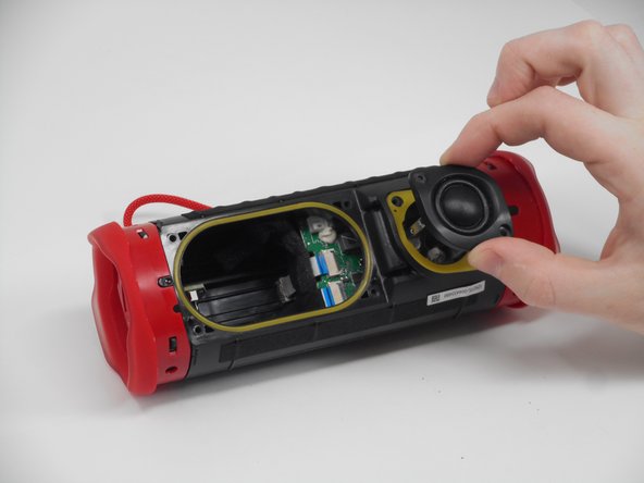

  4. JBL Flip 6 Motherboard Replacement, Tweeter: crwdns2935265:04crwdnd2935265:01crwdnd2935265:02crwdne2935265:0 JBL Flip 6 Motherboard Replacement, Tweeter: crwdns2935265:04crwdnd2935265:02crwdnd2935265:02crwdne2935265:0
    • Remove the two 9.5-mm Philips #1 screws securing the tweeter to the device.
  5. JBL Flip 6 Motherboard Replacement: crwdns2935265:05crwdnd2935265:01crwdnd2935265:03crwdne2935265:0 JBL Flip 6 Motherboard Replacement: crwdns2935265:05crwdnd2935265:02crwdnd2935265:03crwdne2935265:0 JBL Flip 6 Motherboard Replacement: crwdns2935265:05crwdnd2935265:03crwdnd2935265:03crwdne2935265:0
    • Insert an opening pick into the gap along the edge of the tweeter.
    • Push the tip inwards and pry upwards to release the tweeter from the motherboard.

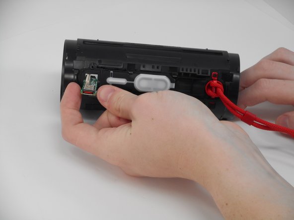

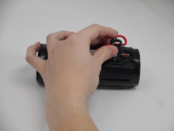

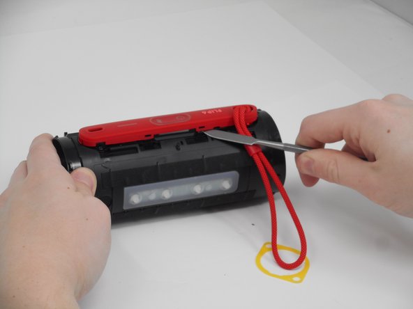

  11. JBL Flip 6 Motherboard Replacement, Charging Port: crwdns2935265:011crwdnd2935265:01crwdnd2935265:02crwdne2935265:0 JBL Flip 6 Motherboard Replacement, Charging Port: crwdns2935265:011crwdnd2935265:02crwdnd2935265:02crwdne2935265:0
    • Use a spudger to release the clips attaching the cover for the buttons and charging port.
    • After the two clips are removed, the cover can be removed easier by hand.
  12. JBL Flip 6 Motherboard Replacement: crwdns2935265:012crwdnd2935265:01crwdnd2935265:02crwdne2935265:0 JBL Flip 6 Motherboard Replacement: crwdns2935265:012crwdnd2935265:02crwdnd2935265:02crwdne2935265:0
    • After the clips have been released, take the cover off, feeding the strap out of the hole.

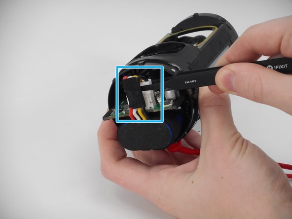

  14. JBL Flip 6 Motherboard Replacement: crwdns2935265:014crwdnd2935265:01crwdnd2935265:03crwdne2935265:0 JBL Flip 6 Motherboard Replacement: crwdns2935265:014crwdnd2935265:02crwdnd2935265:03crwdne2935265:0 JBL Flip 6 Motherboard Replacement: crwdns2935265:014crwdnd2935265:03crwdnd2935265:03crwdne2935265:0

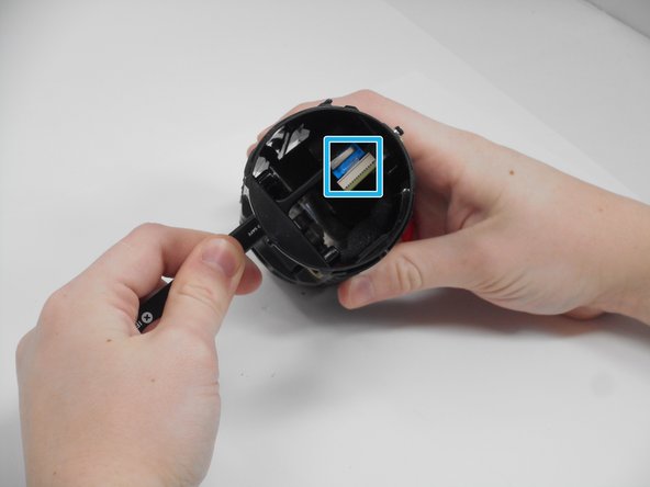

    • Using tweezers, pull the blue ribbon from the connector from the charging port board.
    • After the ribbon is removed, pull the USB-C port out from the outside.

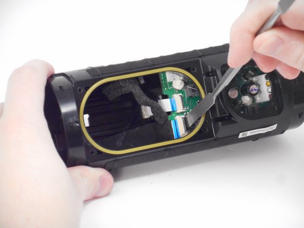

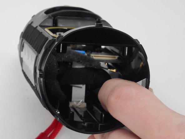

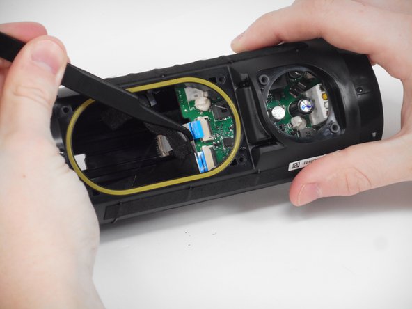

  15. JBL Flip 6 Motherboard Replacement, Motherboard: crwdns2935265:015crwdnd2935265:01crwdnd2935265:03crwdne2935265:0 JBL Flip 6 Motherboard Replacement, Motherboard: crwdns2935265:015crwdnd2935265:02crwdnd2935265:03crwdne2935265:0 JBL Flip 6 Motherboard Replacement, Motherboard: crwdns2935265:015crwdnd2935265:03crwdnd2935265:03crwdne2935265:0
    • Carefully pull the small ribbon cable from its slot.
    • Lift up on the black locking flaps opposite the ribbon cables, then carefully pull the ribbon cables out of their slots.
  16. JBL Flip 6 Motherboard Replacement: crwdns2935265:016crwdnd2935265:01crwdnd2935265:02crwdne2935265:0 JBL Flip 6 Motherboard Replacement: crwdns2935265:016crwdnd2935265:02crwdnd2935265:02crwdne2935265:0

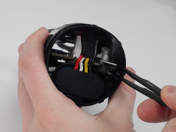

    • Carefully disconnect the small ground connector from the motherboard.
    • When reattaching this connector, it can be tricky to line up and get it to set. The best way to do it is to position the wire with your non-dominant hand, then, using tweezers, pinch the topside of the motherboard and the connector.

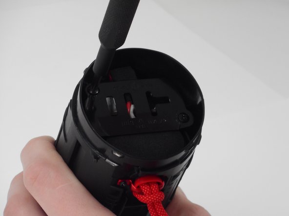

  17. JBL Flip 6 Motherboard Replacement: crwdns2935265:017crwdnd2935265:01crwdnd2935265:03crwdne2935265:0 JBL Flip 6 Motherboard Replacement: crwdns2935265:017crwdnd2935265:02crwdnd2935265:03crwdne2935265:0 JBL Flip 6 Motherboard Replacement: crwdns2935265:017crwdnd2935265:03crwdnd2935265:03crwdne2935265:0

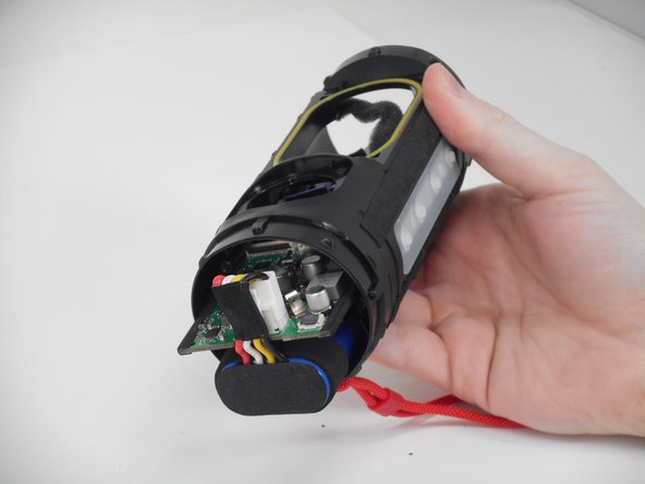

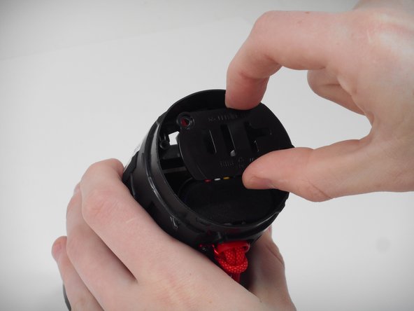

    • Remove the two 9.5 mm Philips #1 screws securing the plastic retainer for the battery and motherboard.
  18. JBL Flip 6 Motherboard Replacement: crwdns2935265:018crwdnd2935265:01crwdnd2935265:02crwdne2935265:0 JBL Flip 6 Motherboard Replacement: crwdns2935265:018crwdnd2935265:02crwdnd2935265:02crwdne2935265:0
    • Pry up on the black tab, then carefully pull the connector from its port on the motherboard.

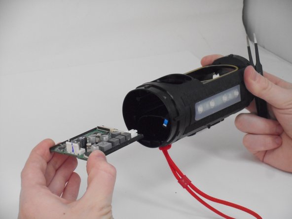

  19. JBL Flip 6 Motherboard Replacement: crwdns2935265:019crwdnd2935265:01crwdnd2935265:03crwdne2935265:0 JBL Flip 6 Motherboard Replacement: crwdns2935265:019crwdnd2935265:02crwdnd2935265:03crwdne2935265:0 JBL Flip 6 Motherboard Replacement: crwdns2935265:019crwdnd2935265:03crwdnd2935265:03crwdne2935265:0

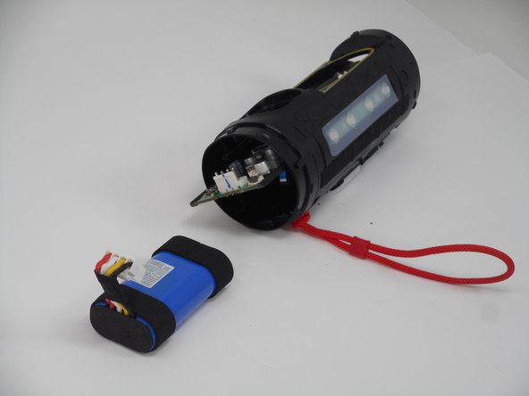

    • Push on the inside edge of the motherboard until the battery connector is outside of the device case.
    • Pinch and pull up on the battery connector to release it, freeing both the motherboard and the battery for removal.
  20. JBL Flip 6 Motherboard Replacement: crwdns2935265:020crwdnd2935265:01crwdnd2935265:03crwdne2935265:0 JBL Flip 6 Motherboard Replacement: crwdns2935265:020crwdnd2935265:02crwdnd2935265:03crwdne2935265:0 JBL Flip 6 Motherboard Replacement: crwdns2935265:020crwdnd2935265:03crwdnd2935265:03crwdne2935265:0
    • Pull out both the battery and motherboard, and repair or replace as needed.
