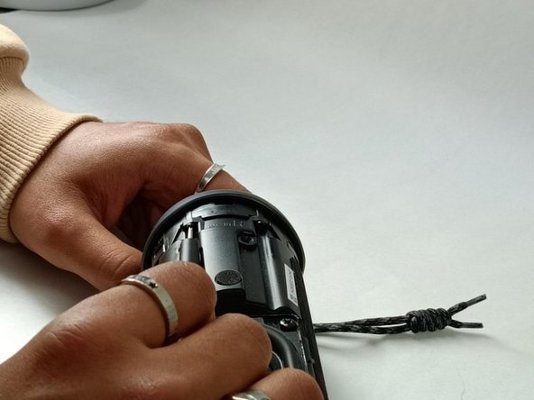

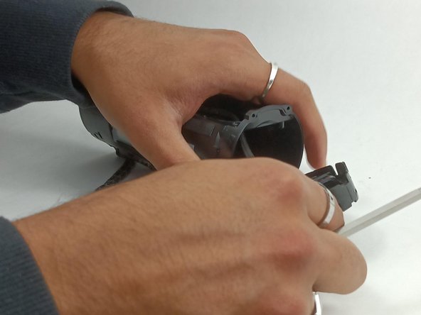

    • Insert the flat edge of the metal spudger underneath the corner of the outer case.
    • Use the spudger to pry open the plastic clips that secure the outer case.
  2. JBL Flip 5 Motherboard Replacement: crwdns2935265:02crwdnd2935265:01crwdnd2935265:01crwdne2935265:0

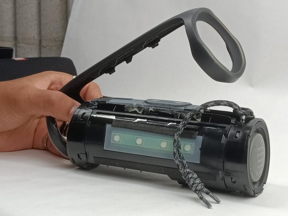

    • Once all the clips are released, you will be able to pull up that edge of the case.
  3. JBL Flip 5 Motherboard Replacement: crwdns2935265:03crwdnd2935265:01crwdnd2935265:01crwdne2935265:0
    • Once one side is released, complete the previous two steps with the other side.
    • This side contains the buttons, so be careful so as to not damage them while prying the case off.
  4. JBL Flip 5 Motherboard Replacement: crwdns2935265:04crwdnd2935265:01crwdnd2935265:02crwdne2935265:0 JBL Flip 5 Motherboard Replacement: crwdns2935265:04crwdnd2935265:02crwdnd2935265:02crwdne2935265:0
    • Once all the clips are removed, you can gently remove the outer case.
    • The case is now fully removed. Now a new case will be attached by putting the case into position and pushing on the clips to reattach them.

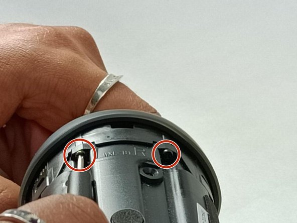

  9. JBL Flip 5 Motherboard Replacement, Buttons: crwdns2935265:09crwdnd2935265:01crwdnd2935265:03crwdne2935265:0 JBL Flip 5 Motherboard Replacement, Buttons: crwdns2935265:09crwdnd2935265:02crwdnd2935265:03crwdne2935265:0 JBL Flip 5 Motherboard Replacement, Buttons: crwdns2935265:09crwdnd2935265:03crwdnd2935265:03crwdne2935265:0
    • The next part needed to remove covers each side and the power and bluetooth buttons in a middle strip along the speaker.
    • The first picture is for reference. That is the part that will be removed.
    • Begin (as shown in the second picture) by unscrewing the two screws (17mm each) with the Philips #00 screwdriver.
    • Then flip the device around and unscrew the other two screws (17 mm each) on the other side just the same.
    • In these pictures the speaker is still in the device. It is best to have already removed it in the Speaker Replacement Guide.

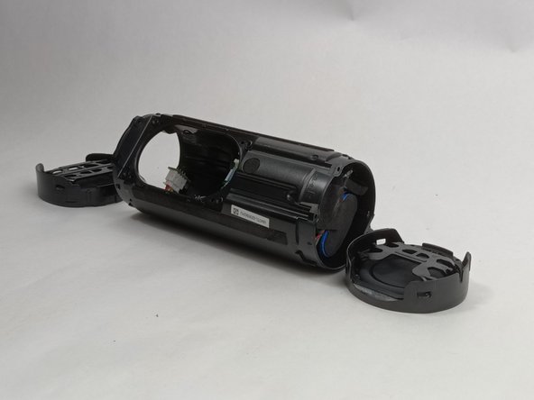

  10. JBL Flip 5 Motherboard Replacement: crwdns2935265:010crwdnd2935265:01crwdnd2935265:02crwdne2935265:0 JBL Flip 5 Motherboard Replacement: crwdns2935265:010crwdnd2935265:02crwdnd2935265:02crwdne2935265:0
    • Once all the screws are removed, pull the passive radiator bracket on either end off.
    • Set the passive radiator bracket to the side. It is not needed for the buttons replacement.

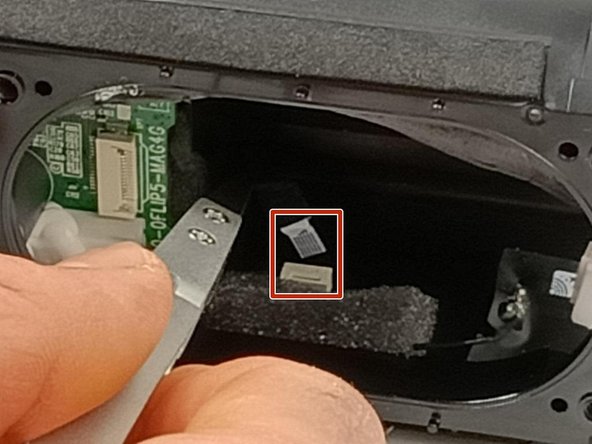

  12. JBL Flip 5 Motherboard Replacement: crwdns2935265:012crwdnd2935265:01crwdnd2935265:02crwdne2935265:0 JBL Flip 5 Motherboard Replacement: crwdns2935265:012crwdnd2935265:02crwdnd2935265:02crwdne2935265:0
    • Once the speaker is removed, you must go in through the hole where the speaker was for this step.
    • There you can use tweezers or your fingers to unhook the connection of the buttons board to the rest of the device.

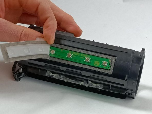

  13. JBL Flip 5 Motherboard Replacement: crwdns2935265:013crwdnd2935265:01crwdnd2935265:02crwdne2935265:0 JBL Flip 5 Motherboard Replacement: crwdns2935265:013crwdnd2935265:02crwdnd2935265:02crwdne2935265:0
    • Peel the rubber cover off using a metal spudger. It may be very sticky, so you may need to pull hard.
    • Then peel the cover off using your fingers.
  14. JBL Flip 5 Motherboard Replacement: crwdns2935265:014crwdnd2935265:01crwdnd2935265:02crwdne2935265:0 JBL Flip 5 Motherboard Replacement: crwdns2935265:014crwdnd2935265:02crwdnd2935265:02crwdne2935265:0
    • Again use the spudger to pull the buttons board off.
    • It is glued down, so you must be very assertive using the spudger.
  15. JBL Flip 5 Motherboard Replacement: crwdns2935265:015crwdnd2935265:01crwdnd2935265:02crwdne2935265:0 JBL Flip 5 Motherboard Replacement: crwdns2935265:015crwdnd2935265:02crwdnd2935265:02crwdne2935265:0
    • In these photos, the buttons board is still on.
    • If only certain buttons are not working it may be appropriate to only replace the buttons board with play/pause and volume up/down. If you are having trouble with the power and bluetooth buttons as well, this step will allow you to replace those.
    • Use the metal spudger to again pull the board containing the power and bluetooth buttons off from the device. It is located next to the strap.
    • It's glued on, use necessary force.

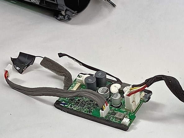

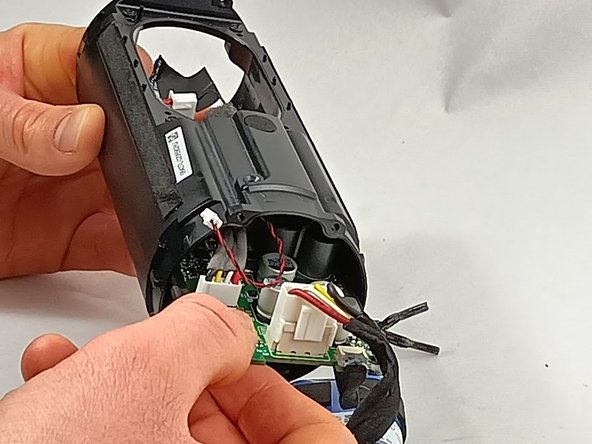

  16. JBL Flip 5 Motherboard Replacement, Motherboard: crwdns2935265:016crwdnd2935265:01crwdnd2935265:01crwdne2935265:0
    • Remove the black tape attached to the inside of the speaker.
    • The adhesive used is strong and may need more force if there is no progress.
  17. JBL Flip 5 Motherboard Replacement: crwdns2935265:017crwdnd2935265:01crwdnd2935265:01crwdne2935265:0
    • Remove the wiring attached to the motherboard and leave it facing away when pulling the motherboard out.
    • This part is attached on and is very tight. Do not pull from the wire and pull from the plastic head to prevent damage.
  18. JBL Flip 5 Motherboard Replacement: crwdns2935265:018crwdnd2935265:01crwdnd2935265:03crwdne2935265:0 JBL Flip 5 Motherboard Replacement: crwdns2935265:018crwdnd2935265:02crwdnd2935265:03crwdne2935265:0 JBL Flip 5 Motherboard Replacement: crwdns2935265:018crwdnd2935265:03crwdnd2935265:03crwdne2935265:0
    • First, slide the battery fully out. You may need to tilt it up slightly to remove it fully and then gently start to pull the motherboard out the same way. Again, you need to gently tilt it up halfway to fully remove it.
  19. JBL Flip 5 Motherboard Replacement: crwdns2935265:019crwdnd2935265:01crwdnd2935265:01crwdne2935265:0
    • Once you have the motherboard removed, repair the motherboard before putting it back in or replace it with a new motherboard.

There seem to be different versions of the Flip 5. My one (I think that it called the GG version) had two ribbon cables attached to the edge shown in step 18 and the rest of the motherboard was different. The problem with my one was that one conductor in the 6 conductor ribbon had been damaged from pressure on something internally which had resulted in a non functioning vol+ button.
