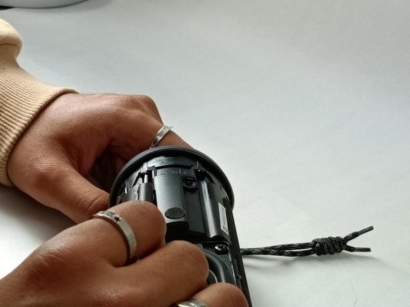

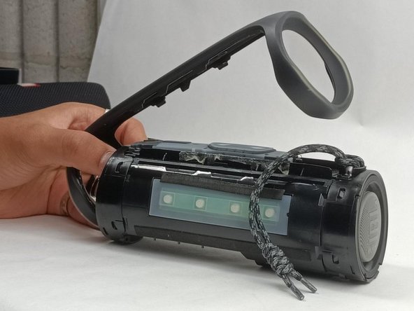

    • Insert the flat edge of the metal spudger underneath the corner of the outer case.
    • Use the spudger to pry open the plastic clips that secure the outer case.
  2. JBL Flip 5 Charging Port Replacement: crwdns2935265:02crwdnd2935265:01crwdnd2935265:01crwdne2935265:0
    • Once all the clips are released, you will be able to pull up that edge of the case.
  3. JBL Flip 5 Charging Port Replacement: crwdns2935265:03crwdnd2935265:01crwdnd2935265:01crwdne2935265:0

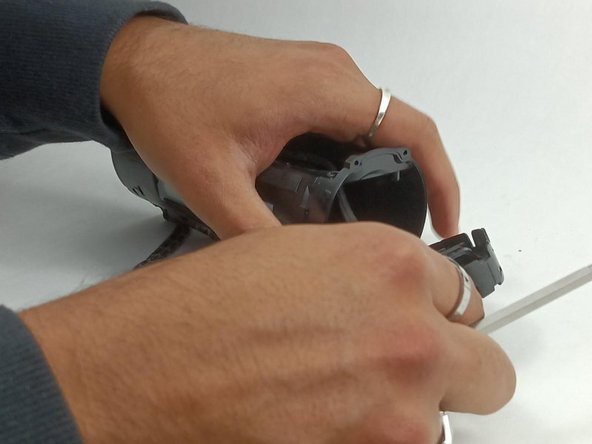

    • Once one side is released, complete the previous two steps with the other side.
    • This side contains the buttons, so be careful so as to not damage them while prying the case off.
  4. JBL Flip 5 Charging Port Replacement: crwdns2935265:04crwdnd2935265:01crwdnd2935265:02crwdne2935265:0 JBL Flip 5 Charging Port Replacement: crwdns2935265:04crwdnd2935265:02crwdnd2935265:02crwdne2935265:0

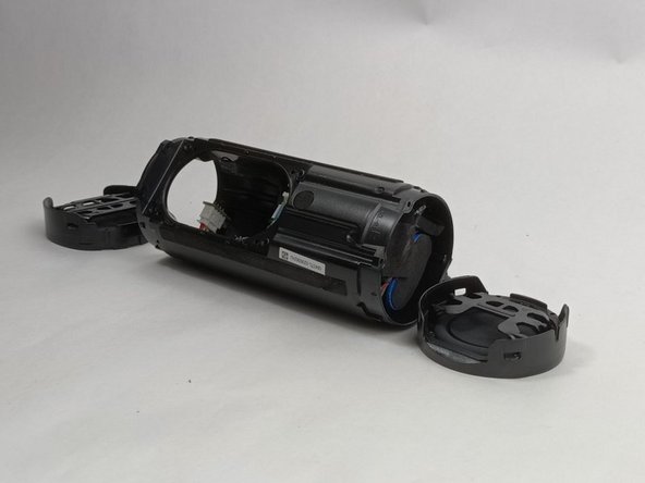

    • Once all the clips are removed, you can gently remove the outer case.
    • The case is now fully removed. Now a new case will be attached by putting the case into position and pushing on the clips to reattach them.

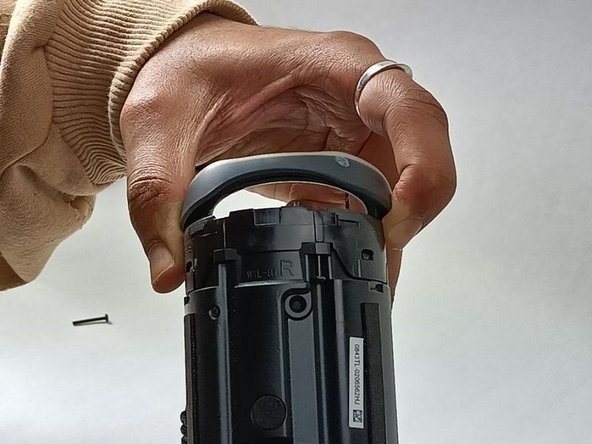

    • Use a Phillips screwdriver to remove the four 17mm-long screws securing the passive radiator bracket.
  6. JBL Flip 5 Charging Port Replacement: crwdns2935265:06crwdnd2935265:01crwdnd2935265:03crwdne2935265:0 JBL Flip 5 Charging Port Replacement: crwdns2935265:06crwdnd2935265:02crwdnd2935265:03crwdne2935265:0 JBL Flip 5 Charging Port Replacement: crwdns2935265:06crwdnd2935265:03crwdnd2935265:03crwdne2935265:0
    • Once the screws are removed, use the metal spudger to remove the passive radiator bracket.
    • Set the radiator bracket aside.

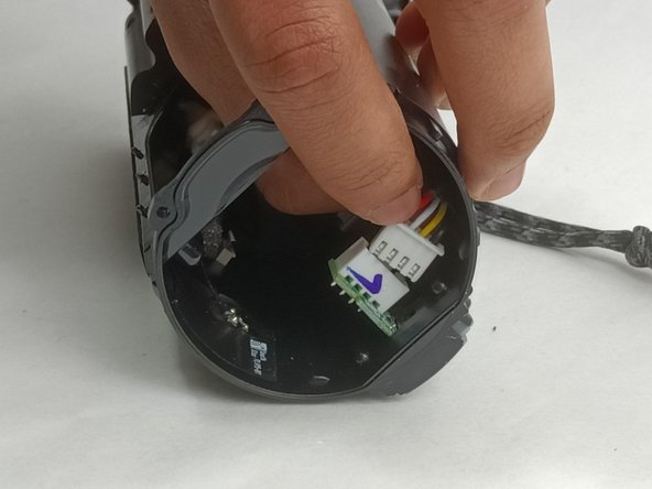

  8. JBL Flip 5 Charging Port Replacement: crwdns2935265:08crwdnd2935265:01crwdnd2935265:02crwdne2935265:0 JBL Flip 5 Charging Port Replacement: crwdns2935265:08crwdnd2935265:02crwdnd2935265:02crwdne2935265:0

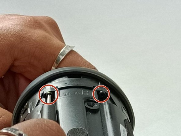

    • Focus on the side of the speaker where the charging port is located and inspect where the passive radiator was before it was removed.
    • Use your hands to unplug the charging cable that connects the charging port to the motherboard.
    • You can use a plastic spudger to assist if necessary.

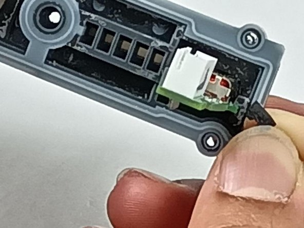

    • There will be two tape like plastic pieces that hold the charging port's circuit in place.
    • Pull these pieces off and you will be able to pull the charging port and its circuit out.
