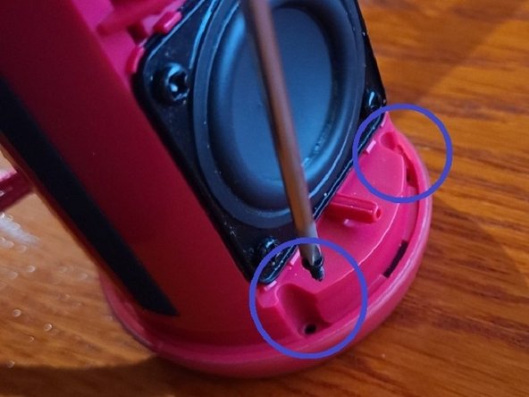

  4. JBL Flip 3 USB Port Replacement, Remove the speaker end caps: crwdns2935265:04crwdnd2935265:01crwdnd2935265:02crwdne2935265:0 JBL Flip 3 USB Port Replacement, Remove the speaker end caps: crwdns2935265:04crwdnd2935265:02crwdnd2935265:02crwdne2935265:0
    • Remove the twelve screws that hold the two speaker end caps (6 per end)
    • Re-assembly notes
    • Align the two holes that are closest together (and pin underneath) to match the chassis holes first to align the entire end cap.
    • Tighten the six (6) screws per end cap (12 total). Do not over-tighten.

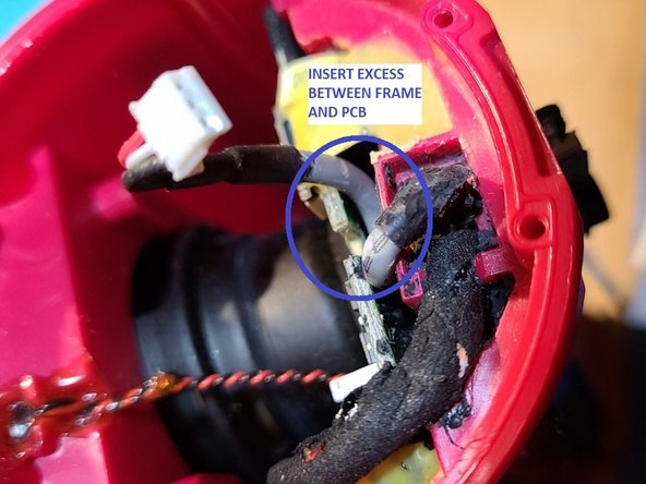

  7. JBL Flip 3 USB Port Replacement, Remove the silicone holding the wires in the end cap cavity: crwdns2935265:07crwdnd2935265:01crwdnd2935265:02crwdne2935265:0 JBL Flip 3 USB Port Replacement, Remove the silicone holding the wires in the end cap cavity: crwdns2935265:07crwdnd2935265:02crwdnd2935265:02crwdne2935265:0
    • From the end cap side, remove the silicone holding the wires in place.
    • Proceed carefully Make sure the speaker is powered off. Avoid cutting the wires. A plastic ustensil is probably best, or a very small, dull screwdriver.
    • This took me about 30 minutes and I forgot to take pictures.
    • Disconnect the AUX input plug and then pull that wire out from under the PCB so it can be aligned with the hole.
    • Re-assembly Notes.
    • Push the AUX wiring between the PCB and the chassis.
    • Plug the AUX connector back in.
