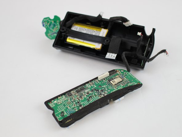

      • Use the black spudger to disconnect the speaker cord from it's socket.
    12. JBL Flip 2 MicroUSB Port Replacement: crwdns2935265:012crwdnd2935265:01crwdnd2935265:02crwdne2935265:0 JBL Flip 2 MicroUSB Port Replacement: crwdns2935265:012crwdnd2935265:02crwdnd2935265:02crwdne2935265:0
      • Use the black spudger to disconnect the auxiliary wire from its socket.
    13. JBL Flip 2 MicroUSB Port Replacement: crwdns2935265:013crwdnd2935265:01crwdnd2935265:01crwdne2935265:0
      • Carefully remove the cable connecting the control chip to the motherboard.
    14. JBL Flip 2 MicroUSB Port Replacement: crwdns2935265:014crwdnd2935265:01crwdnd2935265:02crwdne2935265:0 JBL Flip 2 MicroUSB Port Replacement: crwdns2935265:014crwdnd2935265:02crwdnd2935265:02crwdne2935265:0
      • Using the black spudger, carefully remove the cord connecting the battery to the motherboard.
    15. JBL Flip 2 MicroUSB Port Replacement: crwdns2935265:015crwdnd2935265:01crwdnd2935265:01crwdne2935265:0
      • Carefully remove the cable connecting the nfc chip to the motherboard.

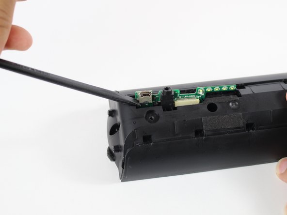

    1. JBL Flip 2 MicroUSB Port Replacement, MicroUSB Port: crwdns2935265:016crwdnd2935265:01crwdnd2935265:01crwdne2935265:0
      • Remove the 7.0 mm Philips #1 screw that connects the I/O board to the casing.
    2. JBL Flip 2 MicroUSB Port Replacement: crwdns2935265:017crwdnd2935265:01crwdnd2935265:02crwdne2935265:0 JBL Flip 2 MicroUSB Port Replacement: crwdns2935265:017crwdnd2935265:02crwdnd2935265:02crwdne2935265:0
      • Remove the white ribbon cable that connects the I/O board to the motherboard.
      • Put the motherboard to the side.
    3. JBL Flip 2 MicroUSB Port Replacement: crwdns2935265:018crwdnd2935265:01crwdnd2935265:02crwdne2935265:0 JBL Flip 2 MicroUSB Port Replacement: crwdns2935265:018crwdnd2935265:02crwdnd2935265:02crwdne2935265:0
      • With the black spudger, carefully wedge out the I/O board.
      • Be careful not to damage the I/O board with the black spudger.

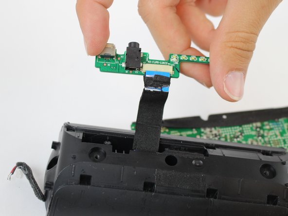

    4. JBL Flip 2 MicroUSB Port Replacement: crwdns2935265:019crwdnd2935265:01crwdnd2935265:03crwdne2935265:0 JBL Flip 2 MicroUSB Port Replacement: crwdns2935265:019crwdnd2935265:02crwdnd2935265:03crwdne2935265:0 JBL Flip 2 MicroUSB Port Replacement: crwdns2935265:019crwdnd2935265:03crwdnd2935265:03crwdne2935265:0
      • Gently pull the I/O board out from the speaker.
    5. JBL Flip 2 MicroUSB Port Replacement: crwdns2935265:020crwdnd2935265:01crwdnd2935265:01crwdne2935265:0
      • Check out IFixit's official soldering guide for help with these special projects.
      • Pry off the loose MicroUSB port.
      • Use the soldering iron to solder the new MicroUSB port onto the I/O board.
      • Soldering iron will be very hot.
