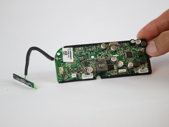

    1. JBL Flip 2 Bluetooth Antenna  Replacement, Bluetooth Antenna: crwdns2935265:016crwdnd2935265:01crwdnd2935265:01crwdne2935265:0
      • Separate the antenna off the plastic wall of the speaker by wedging it with the a spudger.
      • Be careful not to yank it because the antenna is glued to the plastic wall.
    2. JBL Flip 2 Bluetooth Antenna  Replacement: crwdns2935265:017crwdnd2935265:01crwdnd2935265:02crwdne2935265:0 JBL Flip 2 Bluetooth Antenna  Replacement: crwdns2935265:017crwdnd2935265:02crwdnd2935265:02crwdne2935265:0
      • Remove the wire from the insert on the wall of the plastic speaker casing.
      • Separate the entire motherboard from the JBL Flip 2 speaker.
    3. JBL Flip 2 Bluetooth Antenna  Replacement: crwdns2935265:018crwdnd2935265:01crwdnd2935265:01crwdne2935265:0
      • Check out IFixit's official soldering guide for help with these special projects.
      • Using the soldering iron, solder the new wire on.
      • The soldering iron will be very hot.
