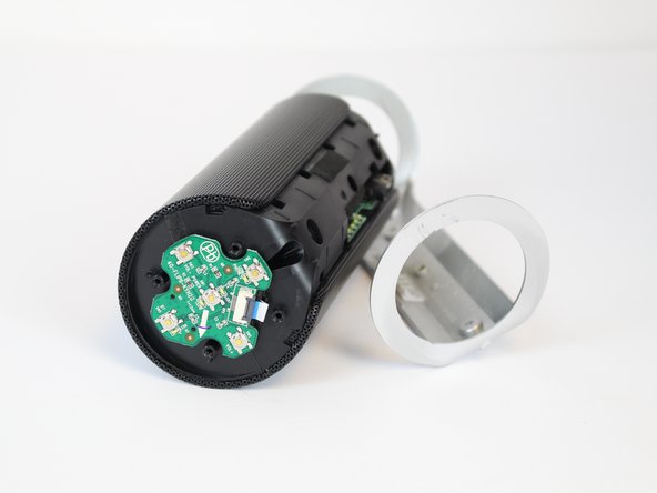

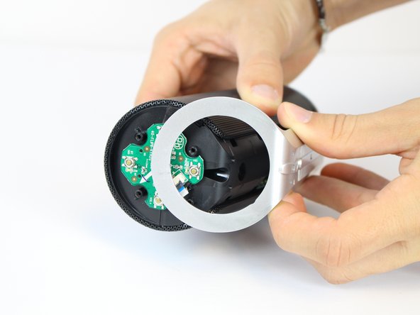

      • Remove the two 7.0 mm Phillips #1 screws.
      • Carefully detach the silver plastic cover by pulling both ends off.
      • Pull both ends at the same time with the same amount of force to prevent the cover from breaking.
      • Separate the silver plastic piece by pulling it off from the middle.

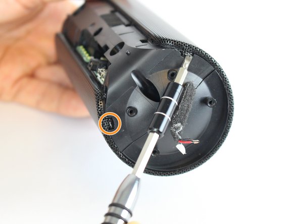

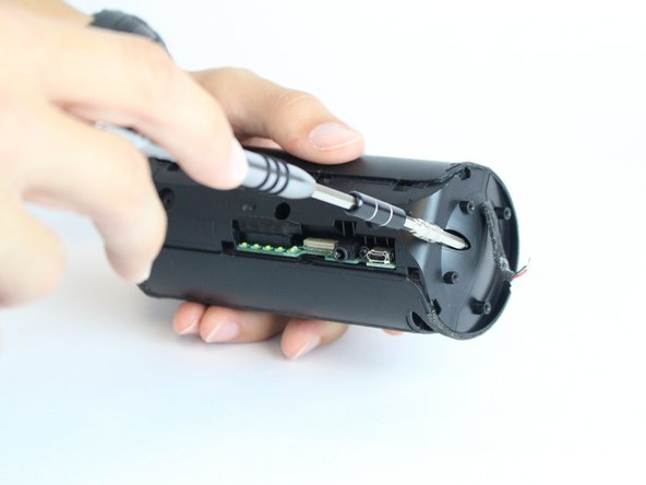

      • Using the driver adapter, first insert the #4 socket into the driver; followed by the #1 Philip's head bit in order to reach the three 13.0 mm screws.

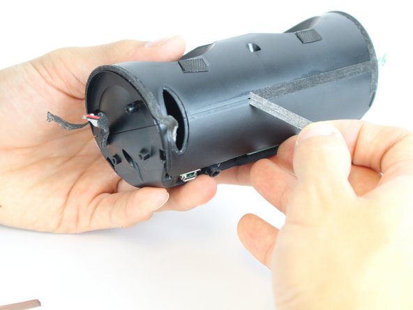

      • Using the classic spudger, get underneath the black tape strips found on both side of the device.
      • After lifting a portion of the tape off of the device, gently peel the tape off of the device, making sure to keep it intact.
      • There is another piece of tape on the side of the device with the control buttons. Lift the tape with the classic spudger and then peel the rest of the tape off.

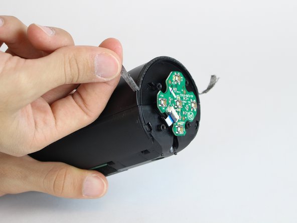

      • Wedge a spudger between the two halves where the tape was to pry the device open.
      • When working with electronics, it's important to choose a tool that's ESD-safe to avoid accidental damage to the device. The regular black nylon spudger or a plastic opening tool should be used whenever possible.

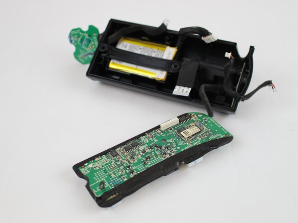

    1. JBL Flip 2 Battery Replacement, Battery: crwdns2935265:016crwdnd2935265:01crwdnd2935265:02crwdne2935265:0 JBL Flip 2 Battery Replacement, Battery: crwdns2935265:016crwdnd2935265:02crwdnd2935265:02crwdne2935265:0
      • Remove the one 7.0 mm Phillips #1 screw attaching the motherboard to the casing.
      • Lift the motherboard out of the case to reveal the battery.
    2. JBL Flip 2 Battery Replacement: crwdns2935265:017crwdnd2935265:01crwdnd2935265:02crwdne2935265:0 JBL Flip 2 Battery Replacement: crwdns2935265:017crwdnd2935265:02crwdnd2935265:02crwdne2935265:0
      • Remove the cord that connects the ports board to the motherboard.
      • Put the motherboard to the side.

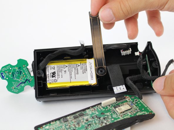

    3. JBL Flip 2 Battery Replacement: crwdns2935265:018crwdnd2935265:01crwdnd2935265:02crwdne2935265:0 JBL Flip 2 Battery Replacement: crwdns2935265:018crwdnd2935265:02crwdnd2935265:02crwdne2935265:0
      • Using the black spudger, loosen the brace holding in the battery.
      • To remove the brace, turn it 90 degrees clockwise and lift it up from its socket.
    4. JBL Flip 2 Battery Replacement: crwdns2935265:019crwdnd2935265:01crwdnd2935265:02crwdne2935265:0 JBL Flip 2 Battery Replacement: crwdns2935265:019crwdnd2935265:02crwdnd2935265:02crwdne2935265:0
      • Using the black spudger, loosen the battery and remove.

I just managed to find a replacement battery for the older JBL Flip2 , which has a LI-ion battery (just three cables with a different connector) for in this feature just the newer Lipo battery is covered:
This is the right battery for the early version:
https://www.amazon.de/gp/aw/d/B002XCR3UI...
it has a different connector , so soldering the old connector to the new battery is required: Easy enough, since the colors are the same - yellow to yellow , black-black and red-red.
it‘s a tiny bit wider so with a knife the side holders have to be cut out a little, you will see when you receive the battery.
open it up first and you will see which version you have, the LIPo version has the connector at the front as pictured above, the LI-ion version has a 3pin connector at the backside of the PCB.
fir this version you need a LI-ion battery as in the link above.
Everything else is just as described above - ists such a great little speaker and Im happy that it plays again… ;-)
