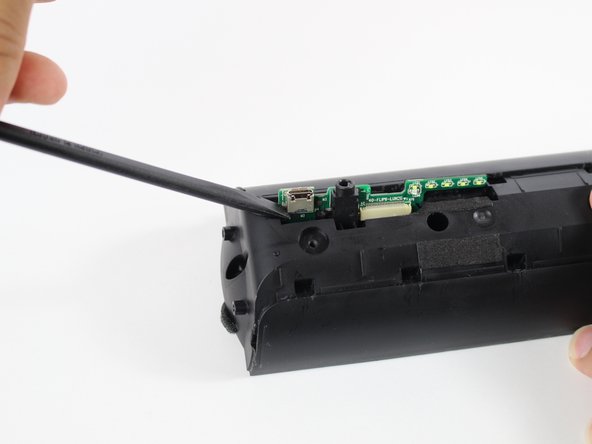

  16. JBL Flip 2 Auxiliary Port Replacement, Auxiliary Port: crwdns2935265:016crwdnd2935265:01crwdnd2935265:01crwdne2935265:0
    • Remove the one 7.0 mm Phillips #1 screw that connects the I/O board to the casing.

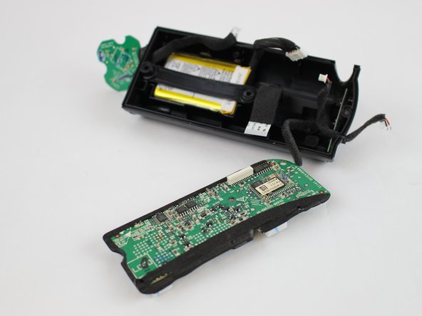

  17. JBL Flip 2 Auxiliary Port Replacement: crwdns2935265:017crwdnd2935265:01crwdnd2935265:02crwdne2935265:0 JBL Flip 2 Auxiliary Port Replacement: crwdns2935265:017crwdnd2935265:02crwdnd2935265:02crwdne2935265:0
    • Remove the cord that connects the I/O board to the motherboard.
    • Put the motherboard to the side.

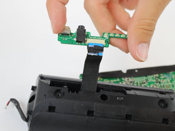

  18. JBL Flip 2 Auxiliary Port Replacement: crwdns2935265:018crwdnd2935265:01crwdnd2935265:02crwdne2935265:0 JBL Flip 2 Auxiliary Port Replacement: crwdns2935265:018crwdnd2935265:02crwdnd2935265:02crwdne2935265:0
    • With the black spudger, carefully wedge out the I/O board.
    • Be careful not to damage the I/O board with the black spudger.
  19. JBL Flip 2 Auxiliary Port Replacement: crwdns2935265:019crwdnd2935265:01crwdnd2935265:03crwdne2935265:0 JBL Flip 2 Auxiliary Port Replacement: crwdns2935265:019crwdnd2935265:02crwdnd2935265:03crwdne2935265:0 JBL Flip 2 Auxiliary Port Replacement: crwdns2935265:019crwdnd2935265:03crwdnd2935265:03crwdne2935265:0
    • Gently pull the I/O board out from the speaker.

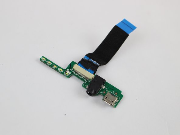

  20. JBL Flip 2 Auxiliary Port Replacement: crwdns2935265:020crwdnd2935265:01crwdnd2935265:01crwdne2935265:0
    • Desolder the auxiliary port to remove it from the I/O board..
    • Check out IFixit's official soldering guide for help with these special projects.
