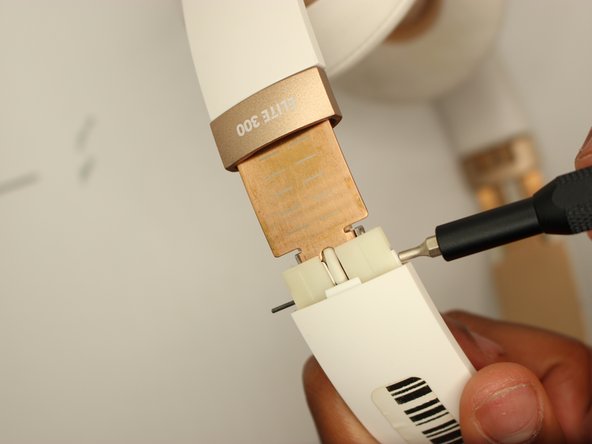

  2. JBL Everest Elite 300 Headband Cushion Replacement: crwdns2935265:02crwdnd2935265:01crwdnd2935265:03crwdne2935265:0 JBL Everest Elite 300 Headband Cushion Replacement: crwdns2935265:02crwdnd2935265:02crwdnd2935265:03crwdne2935265:0 JBL Everest Elite 300 Headband Cushion Replacement: crwdns2935265:02crwdnd2935265:03crwdnd2935265:03crwdne2935265:0
    • Bend the hinge slightly, then remove the two .5 mm screws with a Phillips #000 screwdriver.
    • This will be repeated on both sides.

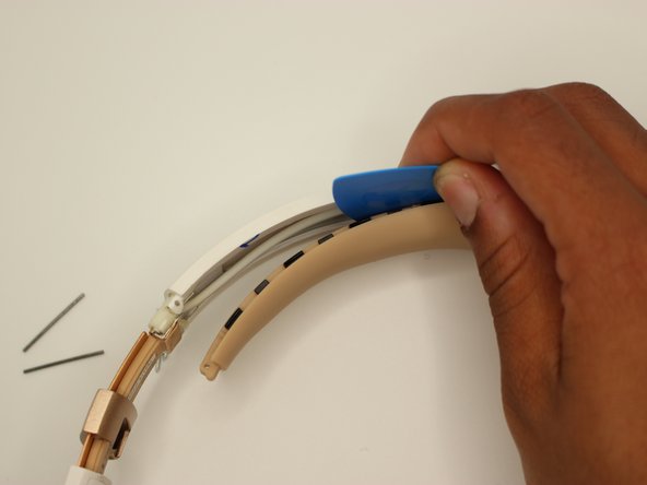

  5. JBL Everest Elite 300 Headband Cushion Replacement: crwdns2935265:05crwdnd2935265:01crwdnd2935265:02crwdne2935265:0 JBL Everest Elite 300 Headband Cushion Replacement: crwdns2935265:05crwdnd2935265:02crwdnd2935265:02crwdne2935265:0
    • Go along the edges with the pick, and pull up, taking off the band.

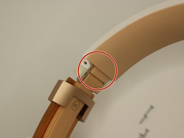

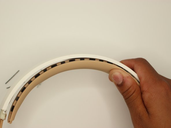

  6. JBL Everest Elite 300 Headband Cushion Replacement: crwdns2935265:06crwdnd2935265:01crwdnd2935265:03crwdne2935265:0 JBL Everest Elite 300 Headband Cushion Replacement: crwdns2935265:06crwdnd2935265:02crwdnd2935265:03crwdne2935265:0 JBL Everest Elite 300 Headband Cushion Replacement: crwdns2935265:06crwdnd2935265:03crwdnd2935265:03crwdne2935265:0
    • After fully taking off the band, you are now ready to insert in the new band.
    • When placing in the new headband, line up the holes as shown in image 2.
    • The headband is difficult to replace, however after lining up the holes, the headband will snap into place. Push into the plastic and push away from you. A click will happen indicating it attatching.
